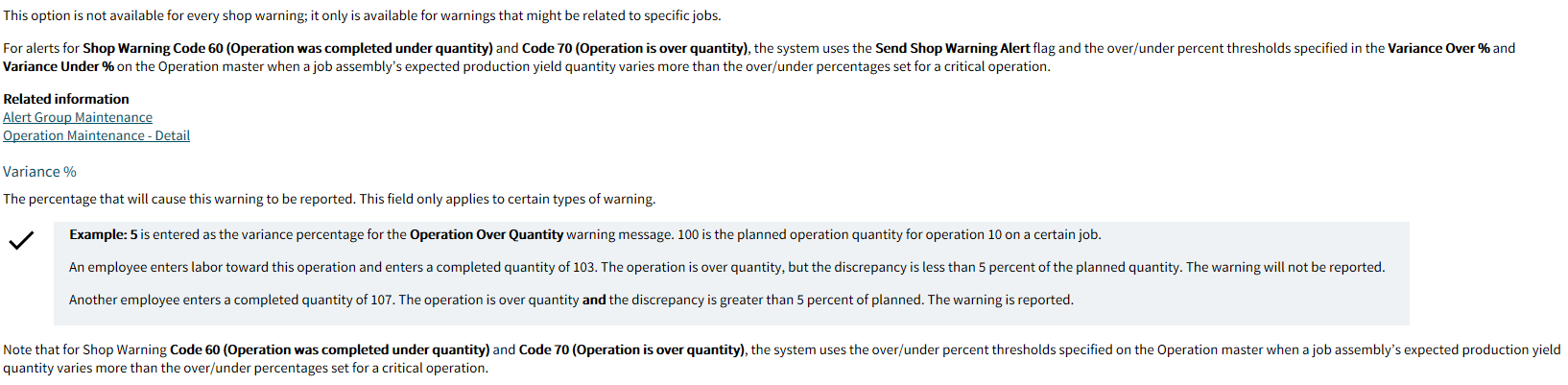

We are seeing the warnings in MES, but according to Epicor documentation KB0133742, “Since ERP 10, email notifications from Shop Warnings require a BPM against the AlertQue table to be set up, in order to send emails.”
The original poster seems to have had the same problem I am experiencing in trying to implement e-mail Shop Warnings - the warnings are not being written into AlertQue to be processed by the AlertQue data directive.
I’m reviewing the configuration to see if we’ve missed something in the Shop Warning configurations or elsewhere that is preventing the expected behavior.
I am working on 2023.2.8 the Global Alert box has been grayed out for Code 70. It very well have been a bug and they turned it off.
