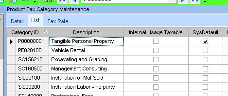

I think the minimum you need to setup (all can be found in Financial Mngmnt → AR → Setup) is:
  • Product Tax Cat - Thes are used to determine the tax rate based on the Goods or Service. We have about 16 categories. These are used for taxes that vary by what the product or service is. 90% of the time we use the Cat “Tangible Personal Property” (which we set as the default). Think of this as the basic Sales tax. If a particular good or service had a special rate, youd make another tax cat for that. Here’s a screen shot showing some of the Tax Cats. Note that TaxConnect actually created these and the CatID is dicated by Avalara. So don’t use any of those codes (or even that format) for your manually setup created codes)

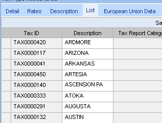

  • Tax Type - This is the “tax” name. Multiple Tax Types can later be assigned to a Tax Liability.
    Typically it’s just the jurisdiction (state, city or locality name). In the shot below, Ardmore is a city in Pennsylvania, while Arizona and Arkansas are obviously states.
    Again, the TaxID’s are created by Avalara, so don’t use any of those or even that format for you manually configured ones.

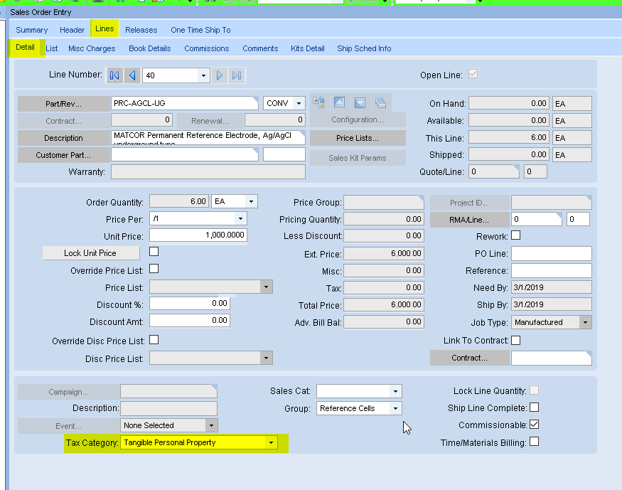

After you setup the Tax Type’s and Tax Cat’s, you use them on order entry and invoicing.
  • Specify the Tax Cat on the order or invoice lines
  • Specify the Tax Liabilty on the release line of orders (because it’s related to the release’s ShipTo address).
