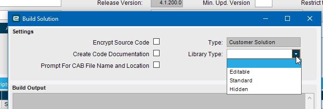

Oh, big bad software company, please tell me it isn’t so and that Wanda didn’t build the solution correctly. That there are indeed ways to modify the functions after being migrated? Maybe there is a fix? Maybe there is an alternate reality of moving back to not including function libraries in the solution.
Well, what would you do if your mother asked you?
You set that when you export the function.
Beautiful tale Steve.
So the only way then is to export it and not use the solution workbench?
Sorry, I meant build the solution.
I’ll give it a test - thank you!
Hmm… not quite there. But I believe it is because it is already read only in the target environment.

Going to delete both libraries and try reimporting…
Wanda put her thinking cap on and realized she had previous imported the function libraries before having Sir Brandon’s gallant solution, thus her libraries were already “read only”. Thinking fast on her feet, unusual for Wanda, she deleted the function libraries, applied the gallant solution and reimported the solution. All ended well as logs don’t lie:
[7/8/2022 1:51:09 PM] Import was successful for ‘FL0002_03fa07ab934a4685ae9aad0e016ddb6c’.
[7/8/2022 1:51:10 PM] Import was successful for ‘FL0015_3a47fbf7753a42d3b7ddaebc01464fbd’.
