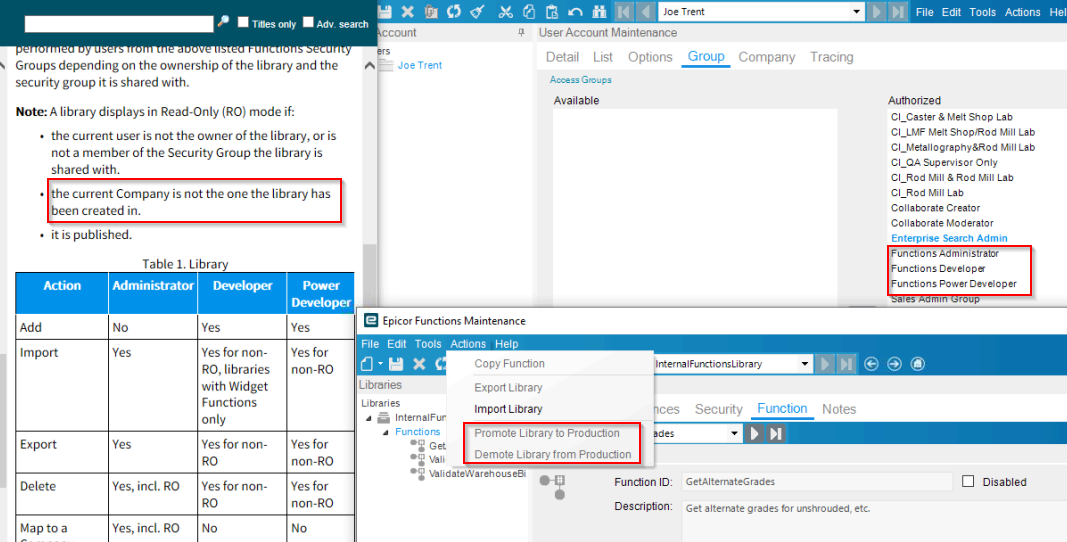

I’ve transferred a batch of functions from an old dev environment to a new dev via a solution. And now my libraries are all read-only on the new one.
My user account is set with the same security groups:
The company code is the same on the new environment.
The only things I can change is the Disabled checkboxes on the library Summary tab and on the Function tab. I can’t copy/export a library or promote/demote a library.
What else might cause the libraries to show as read only?
Thanks,
Joe

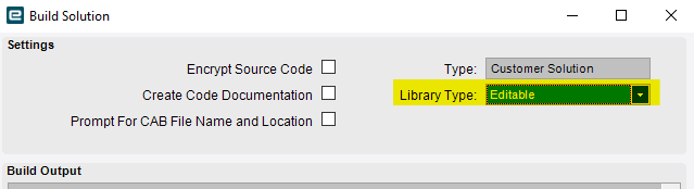

Make sure you mark the Library Type as “Editable” when you build the solution:
Standard would be read only…
Ahh. . .
Thanks, Doug.
