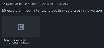

They work fine in 2022 but are broken when importing into 2023.2 that we noticed. So in that case Export it via Function Maintenance and Import via Function Maintenance, I think its a bug - we noticed that too @jgiese.wci and I
