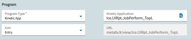

Background: In Pilot, the BAQReport exists as a classic form on one menu and as a Kinetic form on another menu. As far as I can tell, the data definition, reports, and report styles are the same for the Kinetic and Classic screen. It is the Program Type and Program name that are different. The Program name in classic is Ice.UIRpt.BAQReport.dll with the report style name below it of JobPerform_TopL. The program name in Kinetic is Ice.UIRpt.JobPerform_TopL and there is only the URL linked to it. We are also public cloud SaaS and on 2024.2.12.

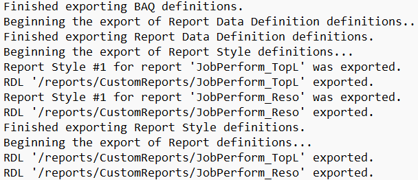

Here are some details from the build:

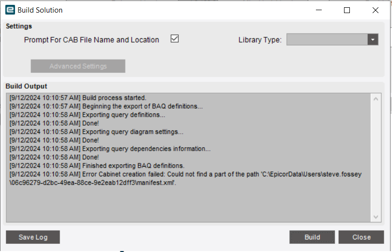

Attempt 3) I built Package 1 which included Report Data Definition, Report, Report Style, and BAQ as recommended by Haso Keric is related post . The build was successful. The install failed. The failure was:
Error Could not find file ‘c:\windows\serviceprofiles\networkservice\appdata\local\temp\e4133792-f61d-45c5-a567-d841436f1035\database\reportstyle_jobperform_topl.xml’.
[3/25/2025 7:09:21 AM] Error Import cancelled or failed for ‘JobPerform_TopL_1_JobPerform_TopL_rdl’.
CChang helped me figure out that security was blocking access to this folder. I resolved the security issue.

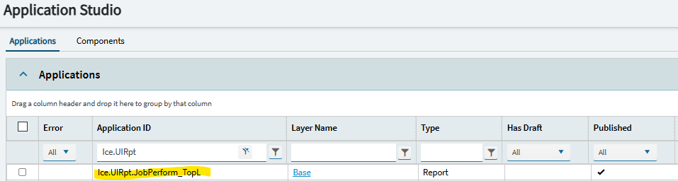

After many more tests, I had to add the menu into the solution. Using BAQReport and Menu element, I was able to build the solution and install it. In application studio I finally see the report!!! :grin:

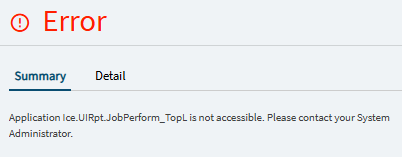

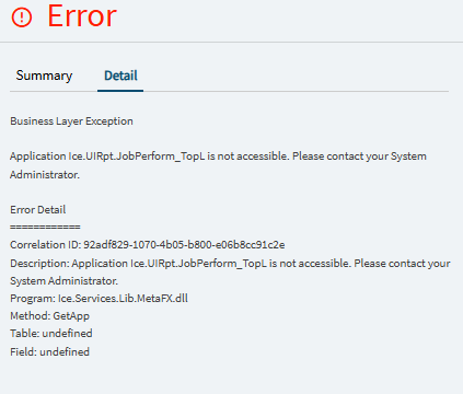

But when I go to use the new menu item, I have this error :face_vomiting:
The application studio layer is completely blank.

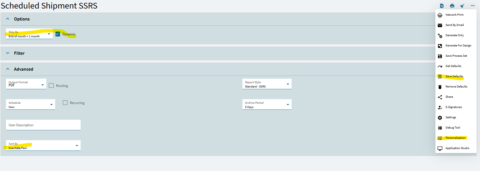

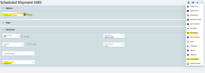

Note 1) We are unable to save layout or personalization to promote it to a customization. I tried this on many of the Kinetic BAQ Reports and they all gave me this error.
Here is the error

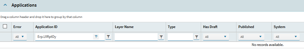

Note 2) For the Dynamic Report, I was able to place it on a menu as Erp.UIDynRpt.JobLabels. It works as a menu item and I can open the Kinetic screen. But I am unable to see any Dynamic Reports in the Application Studio list.

When we install a solution that contains a BAQ Report, we have to then open it once in BAQ Report Designer and select “preview application” from the three-dot menu. As soon as we have “previewed” it once we can then close BAQ Report Designer – you don’t have to save or anything, it now works for everyone. If we don’t do that, we get that same “Application … is not accessible” error. We asked EpicCare about this and were told "Re: Running Preview… That’s expected as well. The BAQ designer needs to do the Preview to build the report on the Application Server. "
