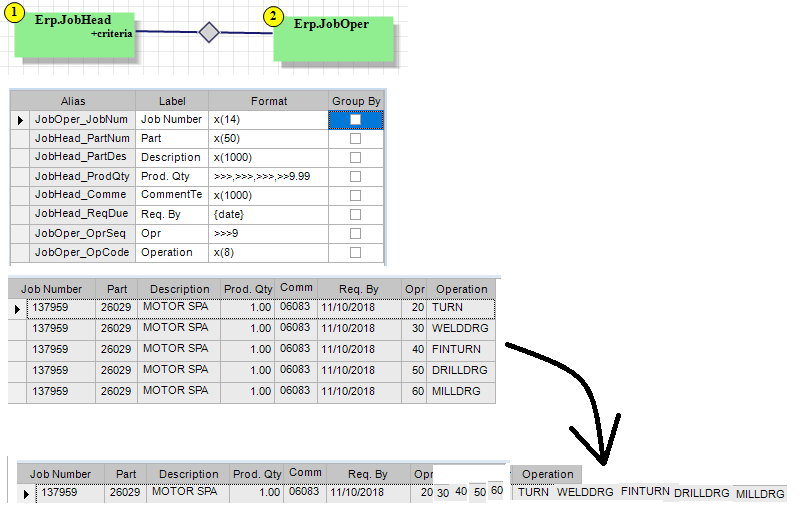

I have a simple BAQ that displays the operations (and other job details) on a job. On the example attached, there are 5 operations, therefore the BAQ displays 5 lines.
Is it possible to modify this where there will be only one line per job, and one column that shows all the operation sequences and/or another column that shows all the operation codes?
Thanks for your help.

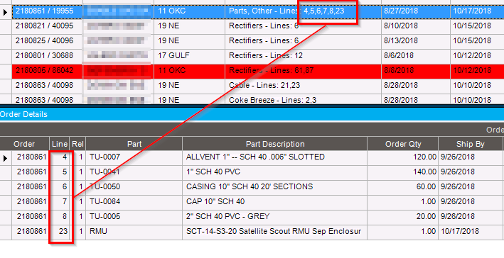

I used it for a BAQ that groups together Order lines with the same Product Group.
The upper pane is summary (Lines with the same Product Group on the same order), the lower shows the individual lines.
