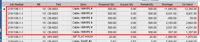

@aarong - I don’t have multiple warehouses, so my example uses PartBin instead of PartPlant to get multiple records.
With a simple BAQ (single query) I get:
There are multiple rows for Mtl 10, because there are multiple PartBin records for that part. Just like you have multiple Warehouses.

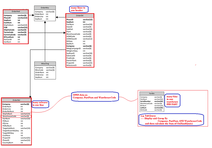

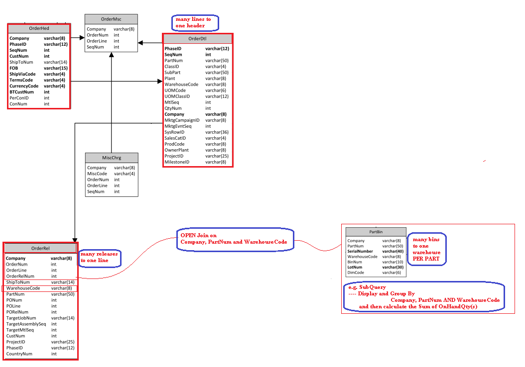

Rather than digging into the specific query, here is a marked up schema screen shot - where I try to display some causes for row multiplication - and pseudo subquery for Part Bin Qtys.

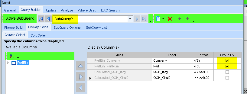

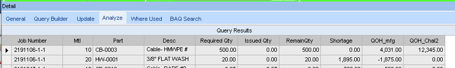

@aarong - I made a subquery containg just the PartBin table, with no table criterial, and the following display fields:
One Calc field for each warehouse, with the formulas:
SUM(case when PartBin.WarehouseCode = 'mfg' THEN PartBin.OnhandQty ELSE 0 end)
and
SUM(case when PartBin.WarehouseCode = 'CHAL2' THEN PartBin.OnhandQty ELSE 0 end)
The difference being which warehouse (mfg or CHAL2).

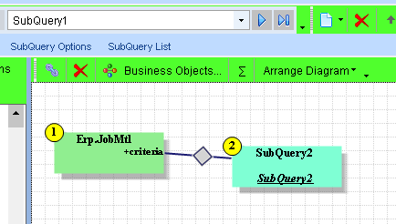

Then used that in place of the PartBin table in the top query:

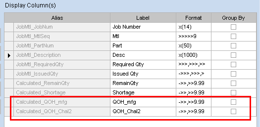

with display fields:
The last two “calc fields” are actually just “fields” from the subquery2. No calculation exists in Subquery1 (the top level query) for those two. The two Calc above it do use fields from JobMtl and Subquery2.
edit
This combines all the part bins for all warehouses into a single record, with individual columns for the warehouse QOH

In post 15, I was mistaken about only having one warehouse - Our production DB has just one per site, but our Test environment has multiple per site. Each row in the screenshot in post 15 was from a different warehouse. The warehouse names weren’t shown.
If i filtered my original BAQ (the one used for post 15) to just be warehouses mfg and CHAL2, then there would have only been 2 of the 6 rows shown.
Post 15 was mostly to show why one would get multiple rows.
After learning that the columns in the Original Poster’s screen shot were for specifc warehouses, I made the sub query so that it returned one row per partnum.
