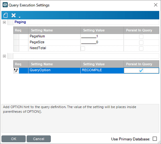

This sounds like a parameter sniffing issue.
I thought BAQ sql queries were recompiled each time?
If not, should he try the Option Recompile trick?
Edit: In case @josecgomez doesn’t get back to us, here is a relevant thread where he goes into it:
it’s probably not this, but it was for us…
every time user A ran a complex BAQ with CTEs it took forever, and we changed the timeout to over an hour, but when user B ran it, 15 minutes was the time. Still long, but for BOMs up to 6 levels deep being recursively parsed and their results analyzed.
Turns out user A always worked on it at night when SQL backups were running.
They are not recompiled automatically. Though I did open an idea about that #GoVote
Yes the recompile trick might help if that’s the issue
