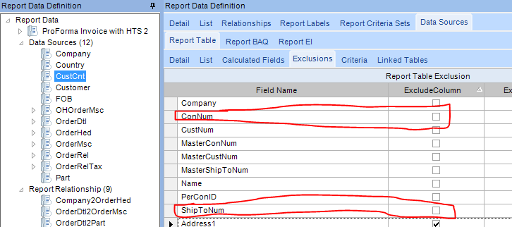

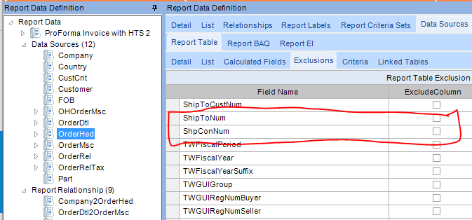

Was either ShipToNum or ConNum an excluded column in the RDD?
BKen
(Brian Ken)
22
Tom,
No, ShipToNum and ShpConNum were not excluded on Order Header:
and ShipToNum and ConNum were not excluded on CustCnt:

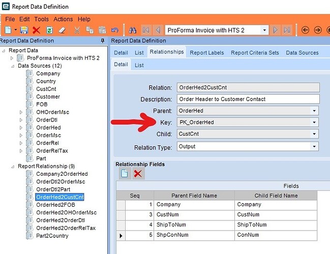

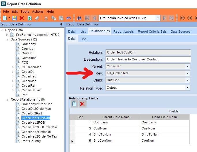

Never use the key field. Always leave it blank.
BKen
(Brian Ken)
24
John,
Can you explain why? The field help does not sound too ominous.
jkane
(John Kane)
25
Just from experience, I forget when I figured it out. Anytime I have tried using that field the report won’t work. Once I remove it it generally does.
