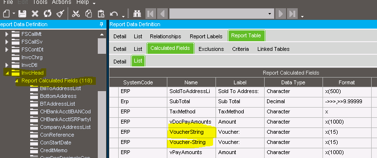

Looking at the original ARForm RDD, it shows there are two calculated fields for VoucherString
One with a “Calc_VoucherString” and the other with “Calc_Voucher-String” (note that’s a dash and not an underscore in the second).
Yet the subreport queries specified “Calc_Voucher_String” in their select clauses.
Go figure…
