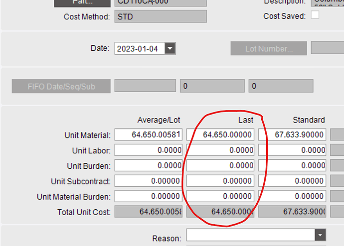

Q2. Our cost method is Std, but the last cost is displayed as well. The last cost of raw materials is displayed at the last purchased price. However, the last cost of the finished goods are displayed as an unknown cost. We create jobs, but we do not use Labor and Burden, only Materials and Operation. How is the last cost of FG calculated in the Std cost setting? Why is this unknown cost displayed?

I’m confused. Which cost on this screen, is to you an unknown value?
I expected that the last cost of this FG would be calculated as the sum of the last purchase prices of RMs. (Because labor and burden are not used, there is only material cost). But, a completely different cost came out.(29,940). So I’m wondering what the last cost calculation of FG is. (Because I don’t think it’s a calculation I know)

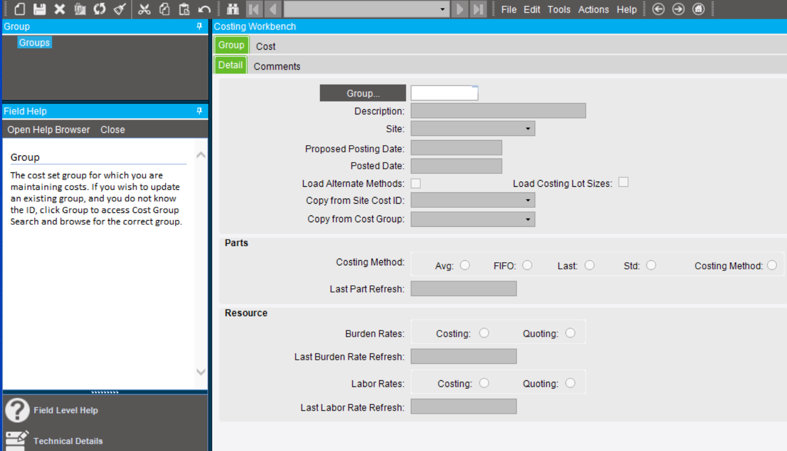

A1) The Information should be in the Costing Workbench Tables. (Use Field help in Costing WB to find)

Thank you for your feedback.
But, I can’t find an answer related to cost history in Costing WB’s field help.
where should i look?
Did you click on the fields you were interested in?

Yes, I clicked
We know that FG’s last cost will come from the last MFG-STK transaction. But, I’m asking this question because I’ve gotten results that aren’t the case.
As shown below, the last cost of any one part is 64,650. But the last MFG-STK cost 61,518. So I was wondering if there is any other logic other than the Last cost calculation logic I know of.
Since we are using the Std cost, this is not a critical problem. just my curiosity

@pilio.lee It says this is solved but you seem to still have questions about last cost, right?
So, in your last post, you aren’t showing a picture of anything labeled MFG-STK. Can you show a picture of Part Transaction History Tracker for the finished part, maybe filtered on MFG-STK? It’s the Unit costs I’m curious about.
I get that you are saying that the job cost is 6,151,800 and probably for 100 pieces, so the per-each cost is 61,518. But if you don’t complete all 100 at once, and/or you don’t charge all of the material and subcontract in-sync with those receipts, it can skew the last and average numbers.
Also, very good point by @Mark_Wonsil - if you bought some of these, that could also be your last cost…
Since we use the Std cost, as you can see, it is displayed as this Std cost in the Part Transaction History Tracker. Last year’s Std cost was 64,650.
While looking for a combination of youguys’ opinions, I think I solved my curiosity.
  1. In the Std cost method, Part trans cost is only represented as Std cost.
  2. FG’s last cost is the last cost of ā€œ???-STKā€, not the last of ā€œMFG-STKā€.
  3. There have been no transactions since the Std cost update, so the last cost was 64,650 which was the Std cost before the update.
All other FGs were also calculated with this logic. In conclusion, in the Std cost method, the last cost of FG displayed is meaningless.
Thanks to all of you for giving me insight.
