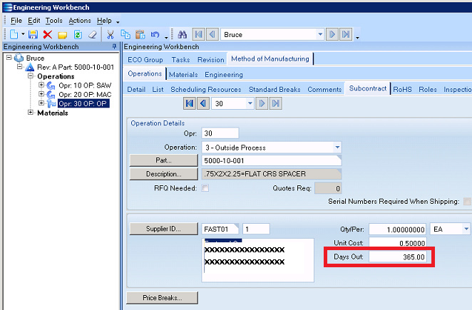

i am trying to figure out if this is set somewhere or it has to be entered when creating Method or a Job. Does anyone know if Days Out can be set on Operation maintenance? I just don’t see it.

You can try looking in the Engineering workbench.
Should be able to set the days out when adding a subcontract operation to the parts methods.
I saw it there and on Job Entry but wasn’t sure if there was a place that would pull it in automatically. Looks like it is on the method.
Yes, it’s on the method. However, if it is always the same for each part as is the case with my company, it’s an easy BPM and user-defined field to specify it on the operation master and enter it automatically.
