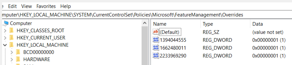

So this ā€œfixā€ seems to only apply to a local group policy. Anyway to push it out to all domain computers?
Is just a Registry Key you can do some snooping around while you apply it to find it, there’s a different one for each Windows Version.
Then you could push it out via GPO to all work-stations.
Was just looking that up @josecgomez - for me I’d want a script I could include as part of a PDQ Deploy package, and think this might be part of the answer:

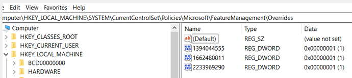

This is what we found… DO NOT USE THIS AS THE BIBLE USE AT YOUR OWN RISK, DON"T BREAK YOUR SHIZ
Each of these is for a different version of windows we deployed all 3 (testing now)
Note: Should be 0 disabled not 1
I wrote a script within our deployment software to check the Windows version first and only applied the specific key for each version. I’m not sure how Windows views these random keys. Applying them all to each client may disable additional items on a different version of Win10. shrug
Yeah that’s a safer approach, do you agree those are thekeys? We had to do some snooping to find them trying to verify we got it right.
I may or may not have taken a look at the admx templates and those are what I may or may not have seen as well :slight_smile:
