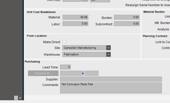

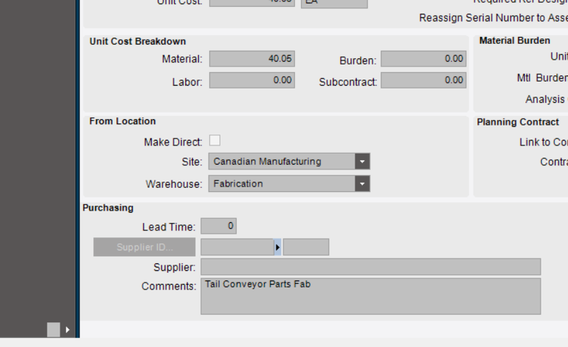

@Matt_Belshaw I would try to use the JobMtl Comment and split PO Line on the Part Class to do this. This is from memory, but I believe the comment goes from the jobmtl to po suggestion and then onto the PO. Set the Job and material sequence in the comment and it should flow. The field help below shows Operation Comment, but I am pretty sure it works for us from the material comment. I also do a lot of shaping on PO suggestions, but I think this just works. If it only gets part way there is a fairly simple calculation using PartDtl to get what jobs are aligned with what suggestions.

Thanks for this Greg. We are currently using split po lines and PO comments for another item but will review this. Did you pre-populate the Job & material sequence in the Part Job comment before running PO suggestions? I could have a PO QTY for a piece of steel for 6 but would be needed as 2x Job1, 2x job2, 1x job3, 1x job4
So thinking this through. If I get a BPM that automatically appends JOBNUM to the Purchasing Comments:
Then split PO will then do the work on splitting the suggestion by job. If we then tweak the PO Suggestion search to find a specific JOBNUM in the comments then the buyer could select all those suggestions and press buy.
