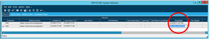

Is there a way to increase the length of time that a Printed\Generated Report stays in the System Monitor (or wherever else it is located - and where else exactly is this report data located?) Right now it looks like the default PurgeDate for us is always 2 hours from when the report is printed/generated. Is there a way I can extend that or temporarily turn it off (which doesn’t sound like a good idea but would maybe be okay in a development environment…?)
I’m working with SSRS reports and my TableGuid is expiring and then I have to re-generate the report and grab a new TableGuid.
Hopefully you can see the image below clear enough…this is just a curious observation but the second entry in the image is for a Crystal Report that was printed on 04/12/2017 2:39PM but the PurgeDate is 04/11/2017 08:00PM. The Crystal Report sat in the System Monitor for like 10 minutes and then disappeared. So it doesn’t seem as if the PurgeDate settings are being applied to our Crystal Reports?

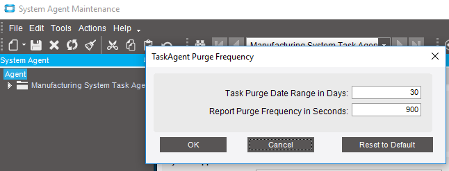

You can change the purge frequency in System Agent - Actions too - Set Purge Frequency
