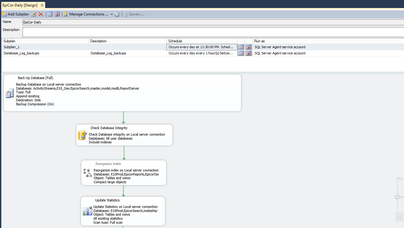

Here’s the job information:
It’s part of the Daily Maintenance plan
It’s just puzzling that the task agent runs into issues whenever SQL starts running something…

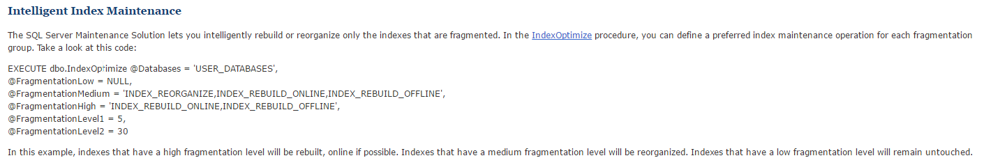

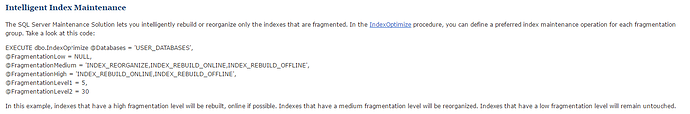

The SQL job is blocking a SQL object that the task agent processing needs. Don’t use the built-in SQL Wizard options for index/stats maintenance as it is overkill. I’d recommend implementing the Ola Hallengren index maintenance script as it only maintains those indexes/stats when it is needed based on the thresholds you set.
A Reorganization is online and non-blocking and it’s most likely the Update Stats Fullscan, that being said definitely use a script to intelligently only reorganize the indexes that need it.
