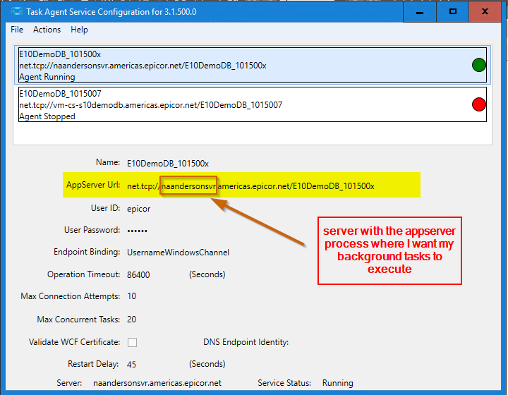

You can change the taskagent configuration on the server with the task agent service installed to the AppServer process that you want to point it to. We point the taskagent to the appserver instead of the appserver to the taskagent. That said, offloading just the taskagent service itself to another server won’t help with performance if that was the intention (just an FYI).
