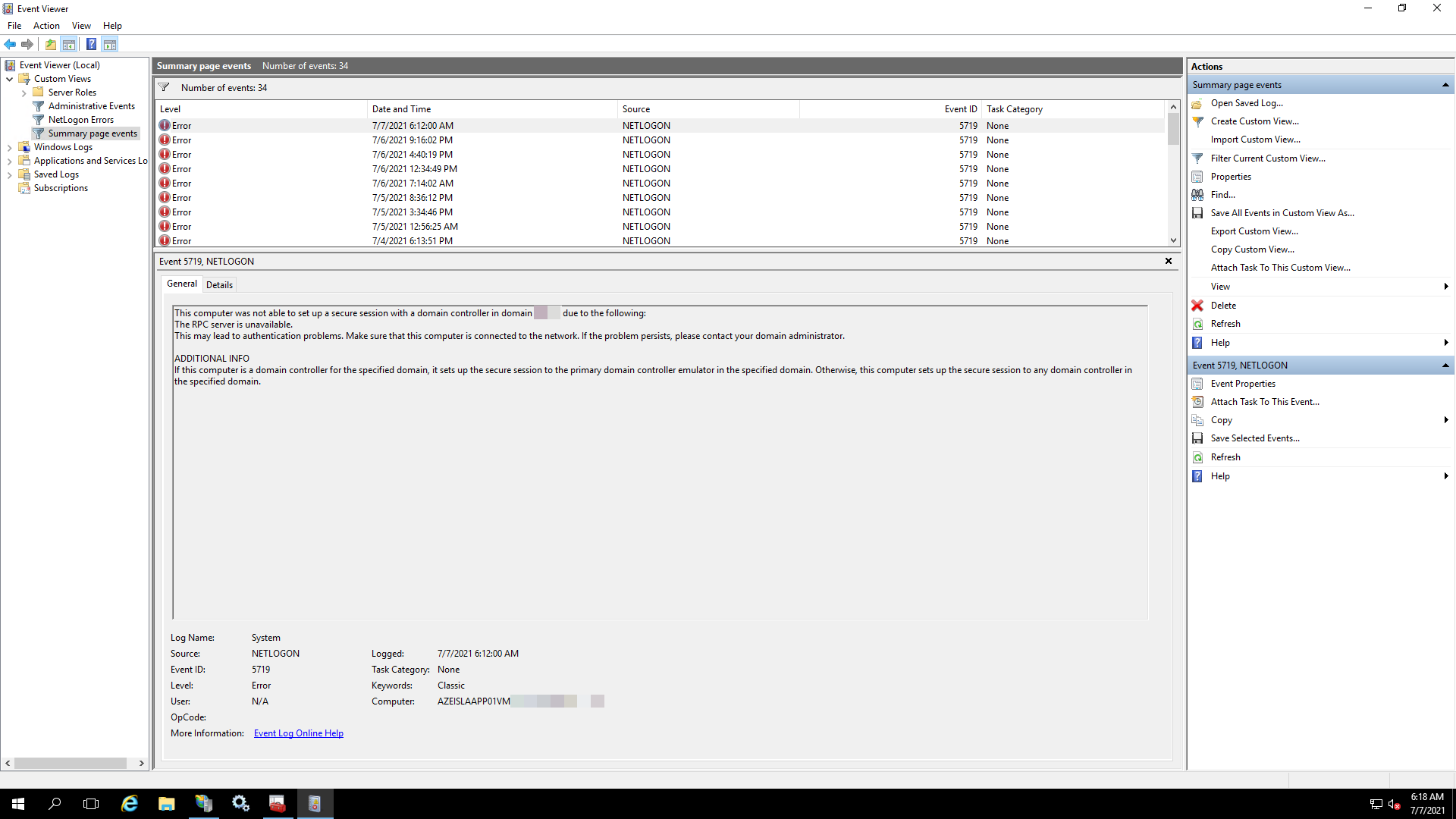

I’m finding the following in the Event Viewer around the time it went down.
Domain issues are a bit outside of my, well, domain.
Does anyone have any ideas?

Your domain controleer is intermittently unaccessible. It is not Erp problem. it just complains about it.
And this is where I falter. I’m not too sure how to troubleshoot a domain controller issue. Was kinda hoping someone would have some suggestions to look at.

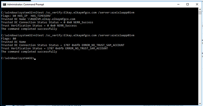

Did the one from CMD. It’s clearly something with the domain trusting the server but still not sure what to do.

We have a ticket open with Microsoft. They suggested we demote the DC in Azure and promoting it with read and write since it’s only read right now.
Promoting the Azure DC did the trick. :+1:
