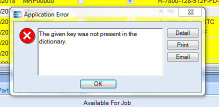

Has anyone see this error - It is when right clicking to job entry.
Not that particular error - but in E10.1.500 I notice that if I have service job entry open, and right click any form in a job field, it crashes. Close Service Job Entry, all is good again.
I finally logged a call with Epicor and this was their response.
“As discussed the issue will happens the most on not hard wired systems like laptops or when the client fails to access the database either because is not available or when there are connection issues to the progress server.”
