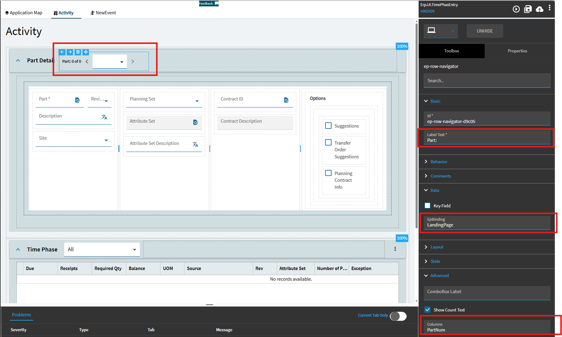

I was able to get my parts to show using the below settings. But selecting a different part doesn’t DO anything. Doesn’t trigger any row-change events. I can play with it more tomorrow.

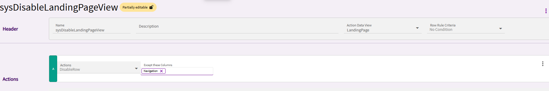

I also had to add my made-up “Navigation” column to the below Data Rule so it wouldn’t be disabled by default:
Like I said, I can make a different selection in the Row-Navigator… but it doesn’t change the value of KeyFields.PartNum which drives the form.

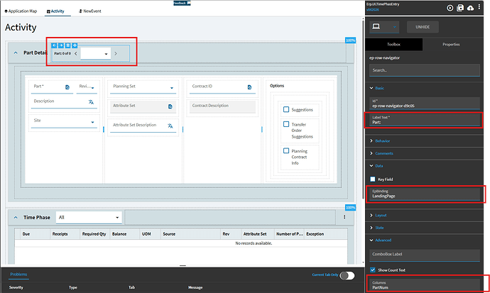

I added a ‘ep-row-navigator’ control to the Grid Card of the Part Detail with an EpBinding of ‘LandingPage’ and Columns set to ‘PartNum’

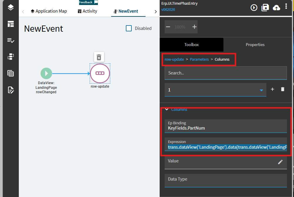

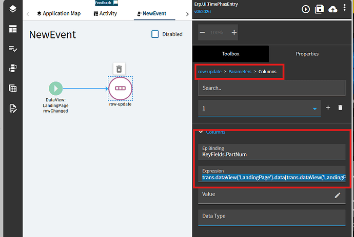

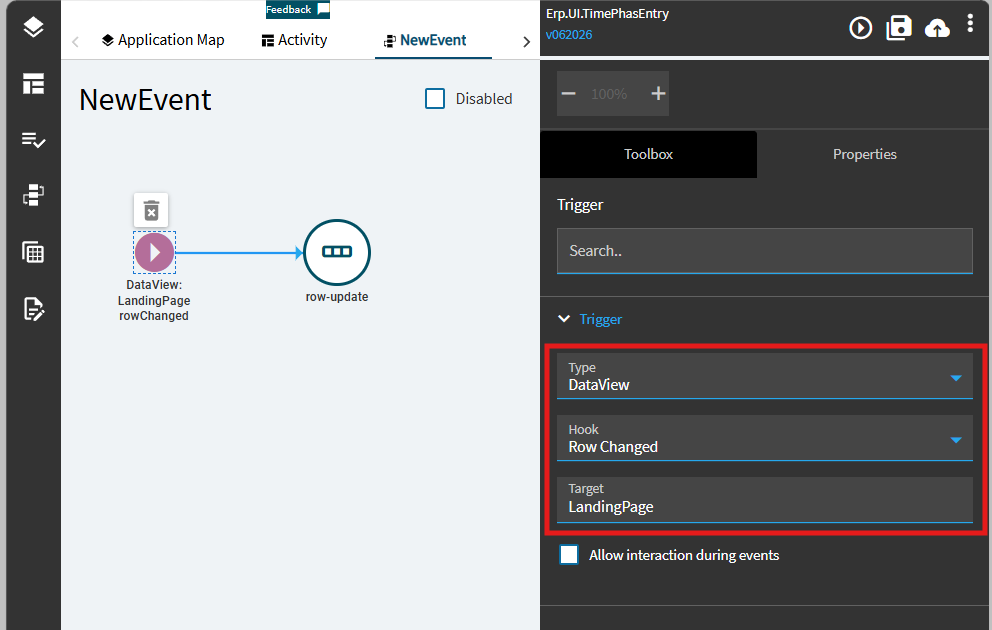

Then I added a DataView Event on ‘LandingPage’ for when the Row Changed:
Called ‘row-update’ that sets the KeyFields.PartNum to the current value of LandingPage.PartNum using the following Expression (which your’s was a great hint for adjusting to fit this):
trans.dataView(‘LandingPage’).data[trans.dataView(‘LandingPage’).row]?.PartNum ?? ‘{KeyFields.PartNum}’
