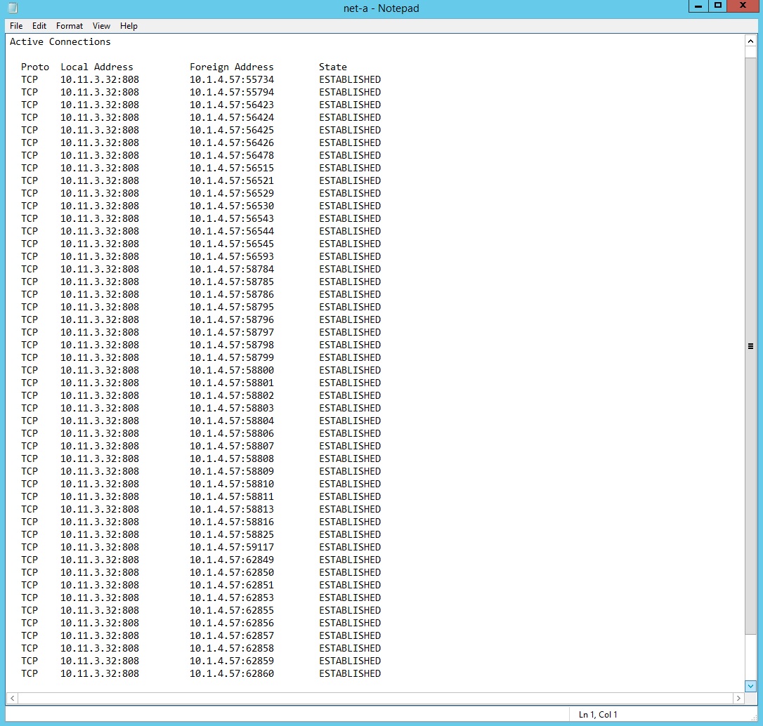

Too many Active TCP connection from Clients appear in the E10 Application server
We observe strange behaviour within Epicor 10 Applications server which the client users connect to it:
When we login to that server and run from “cmd” the comman “netstate” we can see that same IP is having too much active connections/session in the server.
Is that a normal behavior or something could be wrong,
Below output from the server:

Yes I can see too many connections from each e10 client on the server.
So I can understand it is a normal behavior to see many services/connections established from same E10 client on the server ? and nothing wrong with that ?

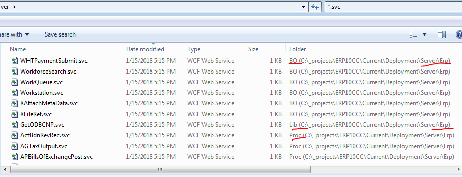

Correct. If you look at the E10 server deployment, you will see over a thousand different services.
-Search for svc files in your server deployment for fun - I have 1721 on my local play instance for example under ice/bo or erp/lib, etc:
Each of those is potentially a stand alone service.
E10 currently shares a common data model and other shared framework functionality so I wouldn’t call each a microservice quite yet :wink:
Each has a pool of listeners that WCF keeps warm and when a client calls comes in, WCF dispatches the request to the appropriate service, standing them up as needed. In this way, server requests are dispatched quickly to a pool of actively used services but the entire site does not sit and grind for 15 minutes on a IIS Reset - Ever wonder why a server is sluggish for a while after a IIS Reset? WCF is standing these services up on first request amongst other areas caches up compiled queries and the like.

Last issue I can see many of these TCP sessions/connection still established even after we close the client from the client side ?
So at the when I close the E10 client all the connections related to that IP/user should disappear, but when I type netstat on the server most of the time I still see session.

If I newly opened it and closed it yes it will close, but after using it for some time and close it, sessions still show on the server.
