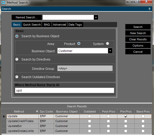

  1. I figured it’s a BPM, but couldn’t see one connected either to the Customer or CustCnt methods that would cause. We’ve got 3 BPM’s connected to the Customer.Update method, but none seem to do this. Is there a way to search for the text in the error message if I export all the BPM’s?

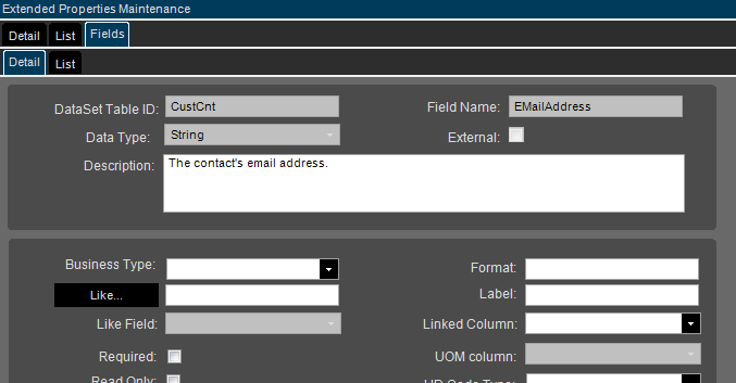

  2. I didn’t see a data directive that would do that (just a change log), or something in Extended Property Maintenance making it required.

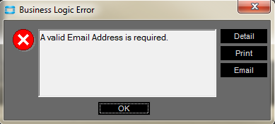

And the full error message:
Business Layer Exception
A valid Email Address is required.
Error Detail
Description: A valid Email Address is required.
Program: Erp.Services.BO.CustCnt.dll
Method: CustCntBeforeUpdate
Table: CustCnt
Field: EmailAddress
Server Trace Stack: at Erp.Services.BO.CustCntSvc.CustCntBeforeUpdate()

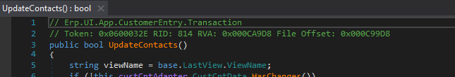

I’d have a look at this func on that form

Chris - Where do dig more into the Erp.UI.App.CustomerEntry.Transaction.UpdateContacts() function?
Decompile that dll:
Erp.UI.CustomerEntry in your client folder. That func is found in the Transaction class
Did you check Extended Property Maintenance? You can set fields to be required there.
Wouldn’t that affect the test customer he created?
If they entered anything, even something like “n/a” or “None” it’d still get past that check as it doesn’t verify a valid email address. We had an issue like this in our old E10.0 that someone set a field to required and it started to cause issues.

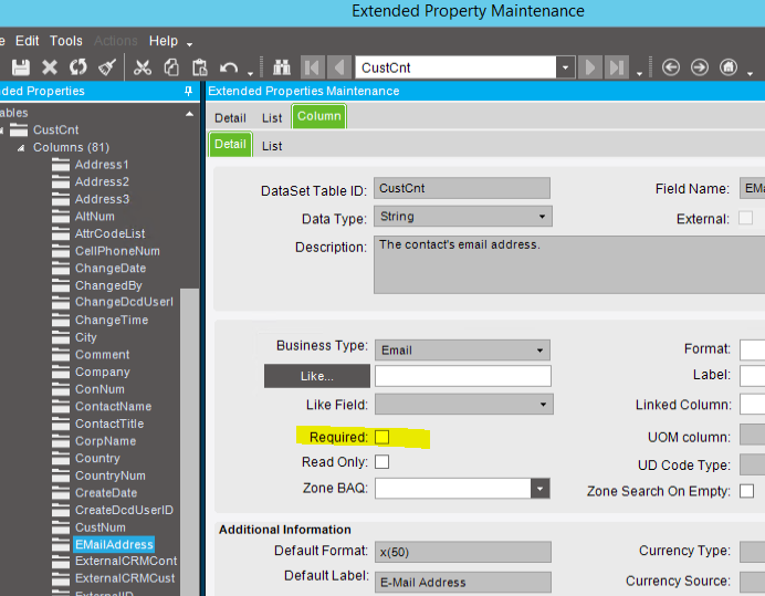

Check the Extended Properties in the CustCnt table. You may have set a REquired Checkbox on that field.
Randy & Jose - Extended Properties in CustCnt table for EmailAddress is not checked ‘Required’. I can create a test customer with a blank email address, with no error. Not sure why this one customer (from what I can tell) has the Alert pop-up as email required.
Chris - Time for me to google how to decompile a DLL. I learn something new every day!

Nah I dont think thats a good direction anymore, it probably wont help unless you are c#'er and intend to dig deep.

Chris - Thanks. dnSpy showed my how complicated it is under the hood! I’m proud of myself for finding the Transaction section, he he he. :slight_smile:

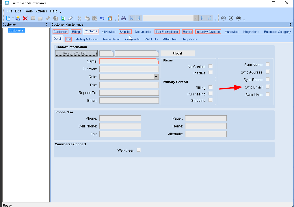

Sync email is checked. I tried with and without, and no change (if I delete email in Customer Maint). If I’m in PerCon, I can delete the email and save without error.

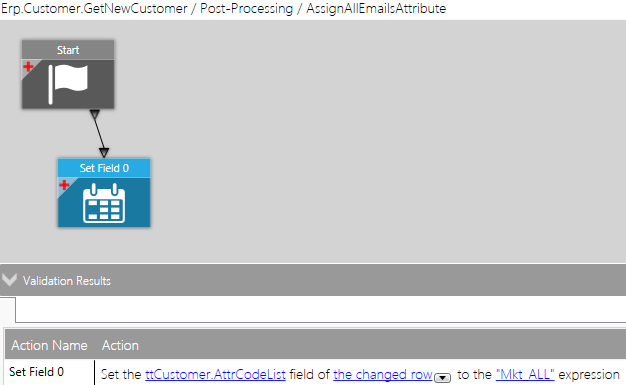

What does the AssignAllEmailsAttribute do?
Chris - AssignAllEmailsAttribute sets the Customer’s attribute to add them to our mailing list.
What about Data Directives, can you show us any Data Directives on the Customer or CustCnt tables?
Also, do you have any Method Directives on the CustCnt BO?

Rick - We have a few Data Directives for Customer, and none for CustCnt. CL-#### is only change logs, and the CatReqAutoPrint and CatRequest are for our mailings, which set fields via widgets, and do not have alerts.
CustCnt has 2 method directives. PrimaryCheckbox sets fields only, and currently isn’t enabled. LimitAMZNContacts shows up blank on the preview screen, and also isn’t enabled. That one looks for a CustID=### condition, and sets the pageSize argument.
