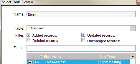

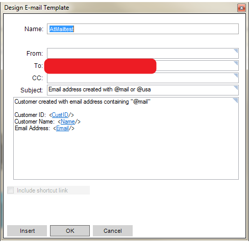

what is in the send email piece of code, this is where the problem might be, if you are using the field to pick it, you may need to put a dummy in the correct format in the bcc or cc box
hi
Andy - It’s a basic outgoing email widget to two people… I would think the conditional logic of matching “@mail” or “@use” would be needed to get to the Send Email widget. Thanks for the ideas!

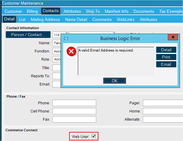

I think I figured this out!
I was reviewing again as I couldn’t get it out of my head, it didn’t make sense, and I realized that you are running the same version as one of my clients and they let me mess around in their test DB, so I thought it might be a bug I could replicate, that didn’t work.
I was looking at @Chris_Conn post earlier with the Customer Contact screen and I realized I had seen this error before.
It’s 'Commerce Connect. If Web User (SFUser) is enabled for a contact you MUST provide an email address:
Rick for the win!!! Yeah! That was it!
Hooray for smart developers with a lot of random knowledge gained by painful experience instead of thorough error details, he he he.

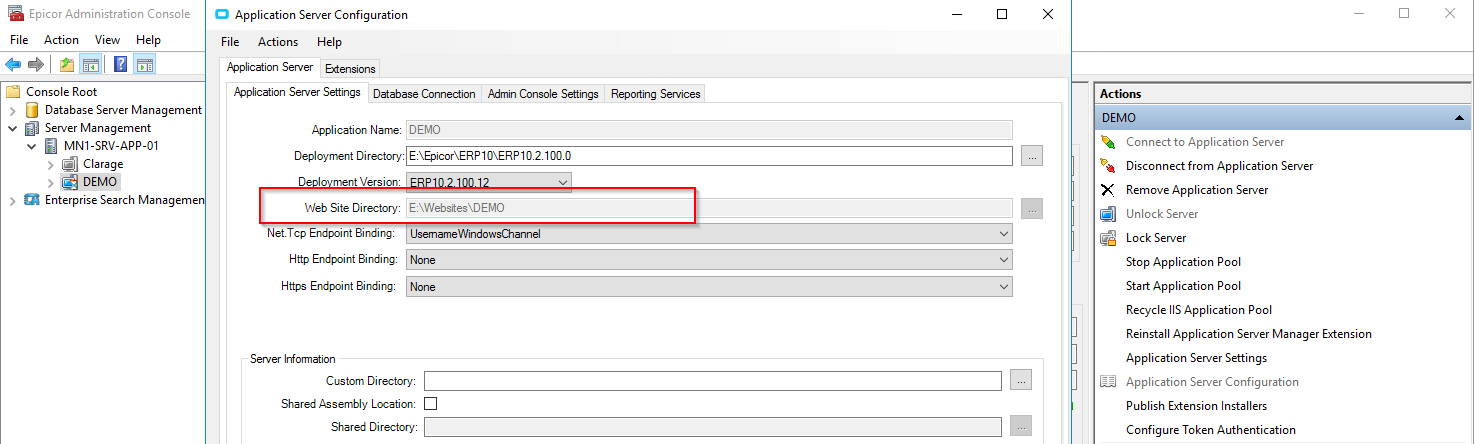

The Erp.Services.BO.CustCnt.dll would be on the server in the folder that the application was setup in. You can find the application folder by looking in the Epicor Admin Console and under server configuration
Thanks Dan - Found it, and now have another tool in the bag of tricks.
