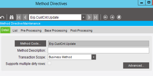

I believe that this is simply the CustCnt business object. image
The tracing showed CustCntImpl and I couldn’t find that anywhere.

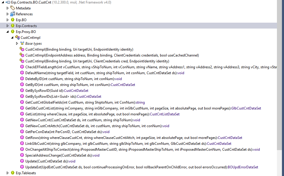

Also, if you use a tool that displays the objects, you can see the details there. For example, we see that CustCnt BO looks like this:
and you can see the CustCntImpl right there.
LOL - I thought that the ā€œImplā€ was suffix added by the trace logging. I just looked for the BO w/o the suffix.
I did use the CustCnt as it made the most sense, without knowing the rest. However, I was using if for GetList, when maybe GetRows or Update was the better option. It was the IMPL that threw me off. Glad @Mark_Wonsil could straighten me out!
