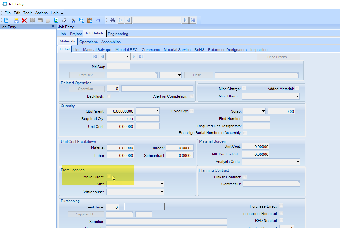

I took a look back at my notes. We have not seen this frequently at all. In my notes I suspected that we had a check on Make Direct in a job material for a transfer part coming up from another plant and then MRP suggest transfer and someone unchecked make direct and the transfer suggestion was in limbo. Make direct from another plant has caused us problems in accounting and so our normal job setup requiring a mfrd part from another plant is make it to stock then do transfer order, then receive to stock and issue to job. Is it possible that someone checked make direct to pull a Mfrd part from another plant?
