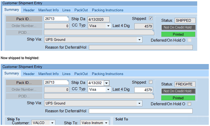

Per epicor you could try this procedure. Important that you notice the fact that you have to change to a “Non-shipping” workstation.
"You can use the following steps to get the pack back in a workable state:
  1. Ensure that you are on an Un-Enabled manifest workstation

  1. Launch Customer Shipment Entry and bring up the pack in question
  2. Enter a stage name in the Stage field
  3. Click Actions -> Stage
  4. Right-click on the stage field and click Stage Ship Confirm
  5. Within the Stage Ship Confirm window, select the pack by clicking the triangle on the left
side of list and click Actions -> Unstage
  1. Click the Refresh button
Notice the Status is now Closed
  1. Highlight the stage name, press the delete or backspace button on your keyboard to erase it
and then click save
  1. Click Actions -> Open
The pack is now open and ready for changes to be made
  1. Make your changes (add/remove lines, etc.)
  2. When finished, click Actions -> Close and then click the Shipped box to change the pack back
to a Shipped status
  1. If you disabled a shipping station in step 1, re-enable the workstation and launch back into an
into it by clicking Options -> Change Workstation from the Vantage home screen"
