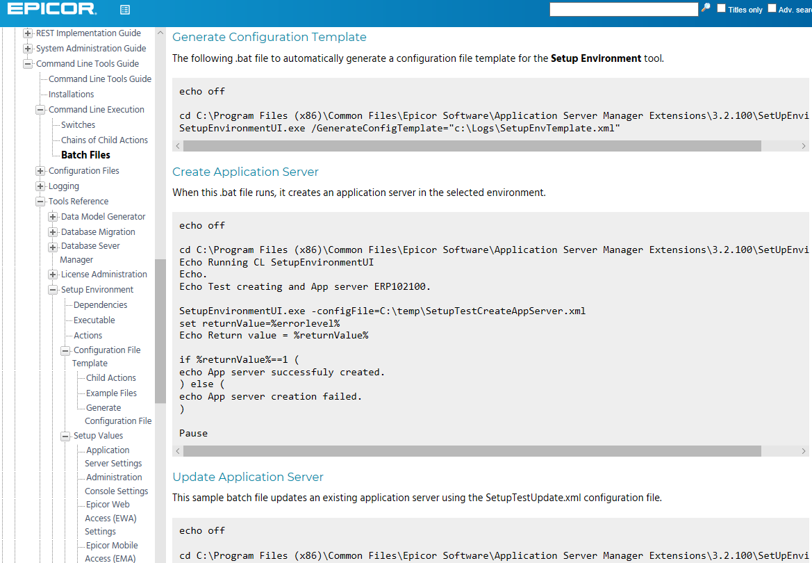

If only there was a place with examples…
(Note - this is the nightly drop of 300 so some of the examples are coming then…)
