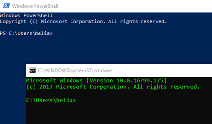

Most of these are written assuming legacy cmd console in Windows and written in the batch file style. We will be introducing our first native PowerShell script in 10.2.300 and assume more will be coming. PowerShell (PS) is ‘eating the world’ when it comes to automation in the data center. If you have not learned it yet, I’ll wait, go look - PowerShell - Wikipedia.
PS is a superset of CLI abilities. It combines classic CMD abilities and dotNet style of coding in it’s scripting language. The blue is a bit rough sometimes on my old greenscreen mind though :wink:
For now, all the Epicor CLI features work in either ‘shell’. As mentioned above, PS scripts will start appearing so getting used to the ‘blue shell’ is a good idea from the beginning though all work today from either.

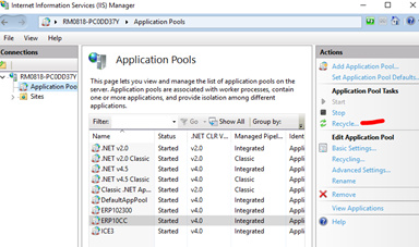

As an example, IIS recycling has a couple of options for example (probably more but I use these two the most).
  • Appcmd.exe is an IIS admin tool and is a ‘legacy’ CLI
    • appcmd recycle apppool /apppool.name=‘MyAppPool’
  • Restart-WebAppPool is a PS ‘cmdlet’ in the WebAdministration package
    • Import-Module WebAdministration
    • Restart-WebAppPool (Get-Website -Name <YourSiteName>).applicationPool
Depending on which tooling approach you use, you can create a little batch script to regen and recycle and kick it odd at midnight or whenever via Windows Task Scheduler or similar timer tool.

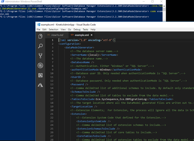

The help walks you thru this. Generate an empty configuration with something like:
Ice.Tool.DataModelGenerator.CL.exe /GenerateConfigTemplate = "Example.xml"

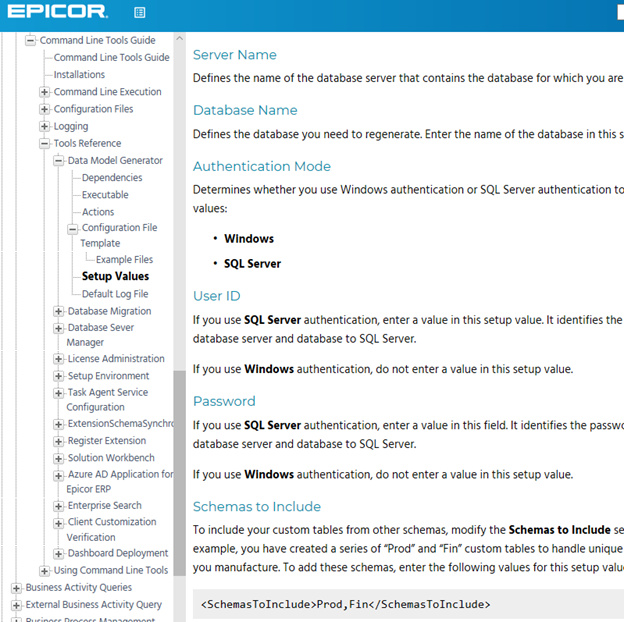

When you open it, you will see the template with a ton of help comments to fill in the blanks. The help for each describes the options and their use.

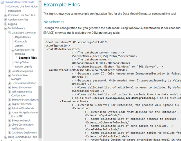

The Help covers what all the values mean and possible values of interest:
And Examples on how to use it:
