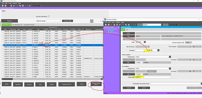

Im trying to do a customization to where we can do a partial processing of a material queue sequence. When a part is received a PUR-STK transaction is created. But we may need to ship some of these out instead of put up. so we might need to do multiple transfers.
Thought a good way to do this would be to do an inventory transfer with the mtl queue sequence as the reference and then do a bpm to subtract that transferred qty from that sequnce once a transfer was made.
most of it is working except I cannot seem to update the mtl que seq qty.

so does anyone know how to modified an existing mtlq row?
You should not have to. If you do a proper partial transfer the remaining quantity will be left for another transfer. We are lot tracked and may process one queue several times.
Do a trace of a and see if any other methods are called, but I am assuming some Epimajic happens to update the queue after it is processed.
Thanks for the reply Greg. I didnt realize we could to partials on a mtl queue seq. the warehouse folks were telling me it would go away if processed. but tested and it deducts the qty. so dont need a mod. would be nice to know how to modify the mtl q seq. I couldnt modify the qty within the material queue manager but did trace changing priority or assigning an employee and all it called was update. all of the rowmod’s were blank.
but sounds like i dont need to worry about it. thanks for the help!
