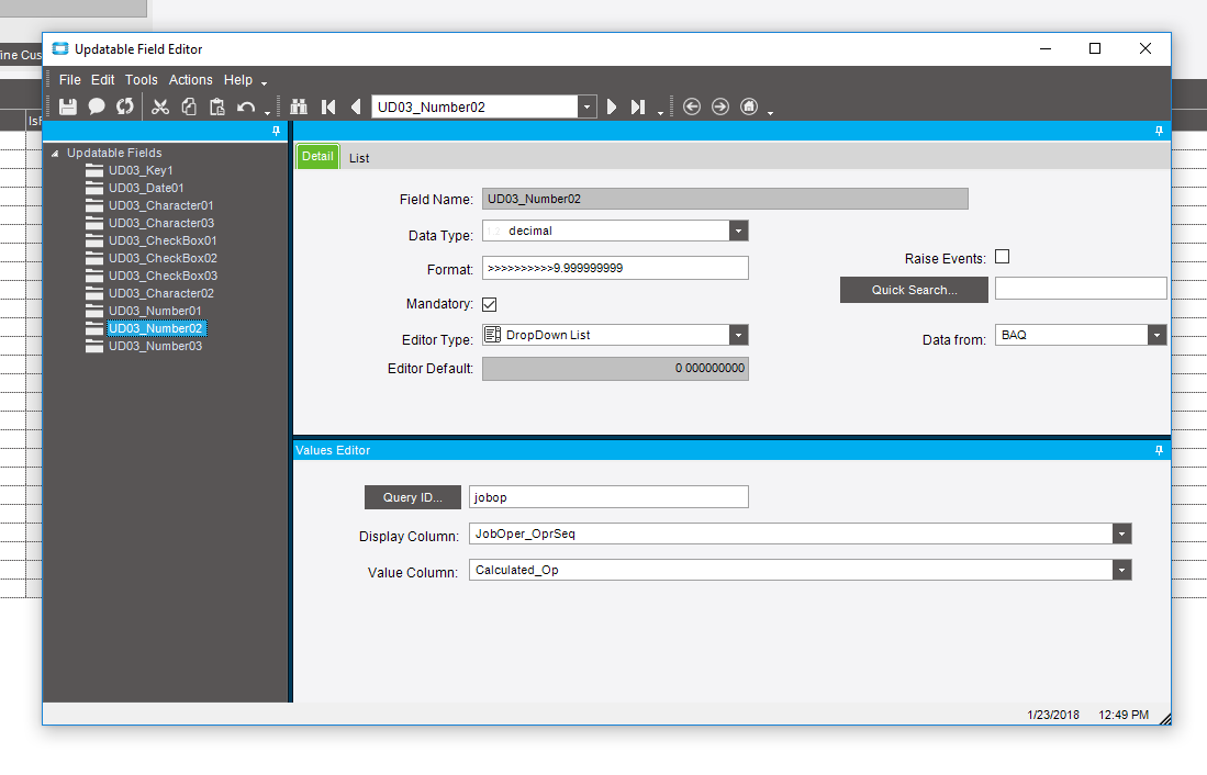

I have just started learning how use updateable BAQ’s, and I am stumped on this one.
This BAQ is a “Outsourcing List”. This just displays items that we are planning to subcontract in the day. It is using the UD03 table to store the data. The idea is that a job, assembly, and operation are added to the list for everyone in our shop to know what is going out.
What I want is for the scheduler to be able to update the operation that is being outsourced. I can do this with a manual entry field, but I would prefer to have a combo box. Ideally, I want this combo box to be filtered by the selected record in the outsource list. It would then only display The Opr seq for that specific job that are subcontract.
I currently have the settings on the field storing the operation as this:
However, this shows every operation seq for every job, I want it filtered to ONLY show the oper seq for the current job. Any ideas?

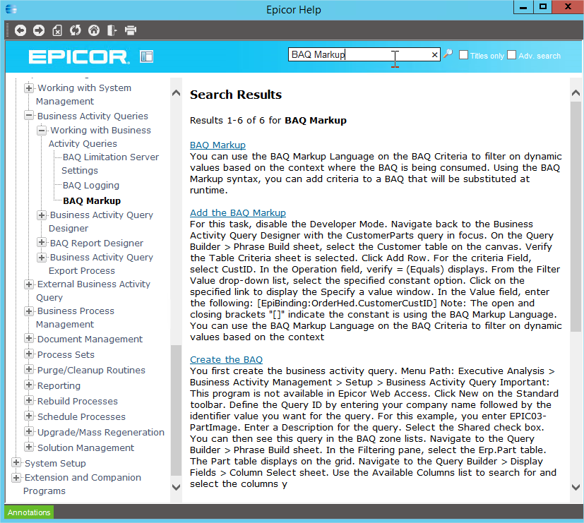

I tried to use various BAQ markups ([EpiBinding:JobNum], [LIKE:JobNum], [CURRENT:JobNumber]) to do this, but it didn’t work, but perhaps I did it wrong, perhaps someone else knows how to do this with BAQ markups or be able to confirm if it’s even possible. I did try different ways of referencing the value with the BAQ Markup (ttResults.JobOper_JobNum, JobOper_JobNum, etc).
If nothing else, I thought I’d give BAQ Markups a plug.
If you don’t know about BAQ Markups, just search Epicor Application Help for BAQ Markups.
Rick, in our 10.1.600 system that phrase returns no results. When I search for the word ‘markups’ alone, I get 18 results but none of them are about BAQs. Is this a new feature in 10.2?
…Monty.
My mistake, the search term is ‘BAQ Markup’, without an ‘s.’
I was never very good at grammar. There are also several other related workshop articles on using them. It’s located under Business Activity Queries > Working with Business Activity Queries:
