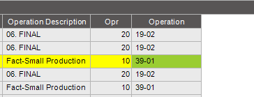

I have an updateable dashboard with a column that is populated with a dropdown from a separate BAQ. The dropdown works great to update the OpCode, but this update does not trigger an update to the OpDescription which retains the old OpDescription. Is there a way to map the dropdown to write to both the OpCode field and OpDescription?
Screenshot of the query below:
Yes. For that field turn on Events and use the Update Table by Query BPM widget in the Field Change event to lookup the OpDesc.
