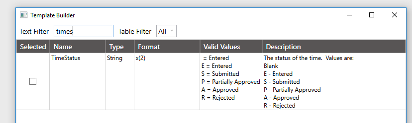

The labor detail has a field that denotes whether it’s approved or not.
LaborDtl.TimeStatus
The status of the time. Values are:
Blank
E - Entered
S - Submitted
P - Partially Approved
A - Approved

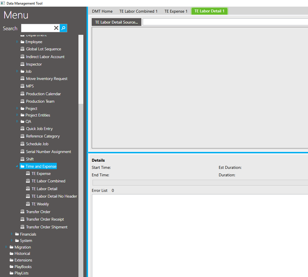

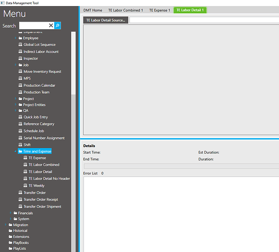

Where is that screen you are showing. I have one Time and Expense Entry
That’s the DMT program
And you can set that in the DMT it looks like.
Right so on the DMT, just put the status in as well. I am just not sure a DMT is the way to go because that means they would have to have access to DMT or someone in IT will have to upload the file. Does that make sense? That’s why I thought service connect would be more sensible.
