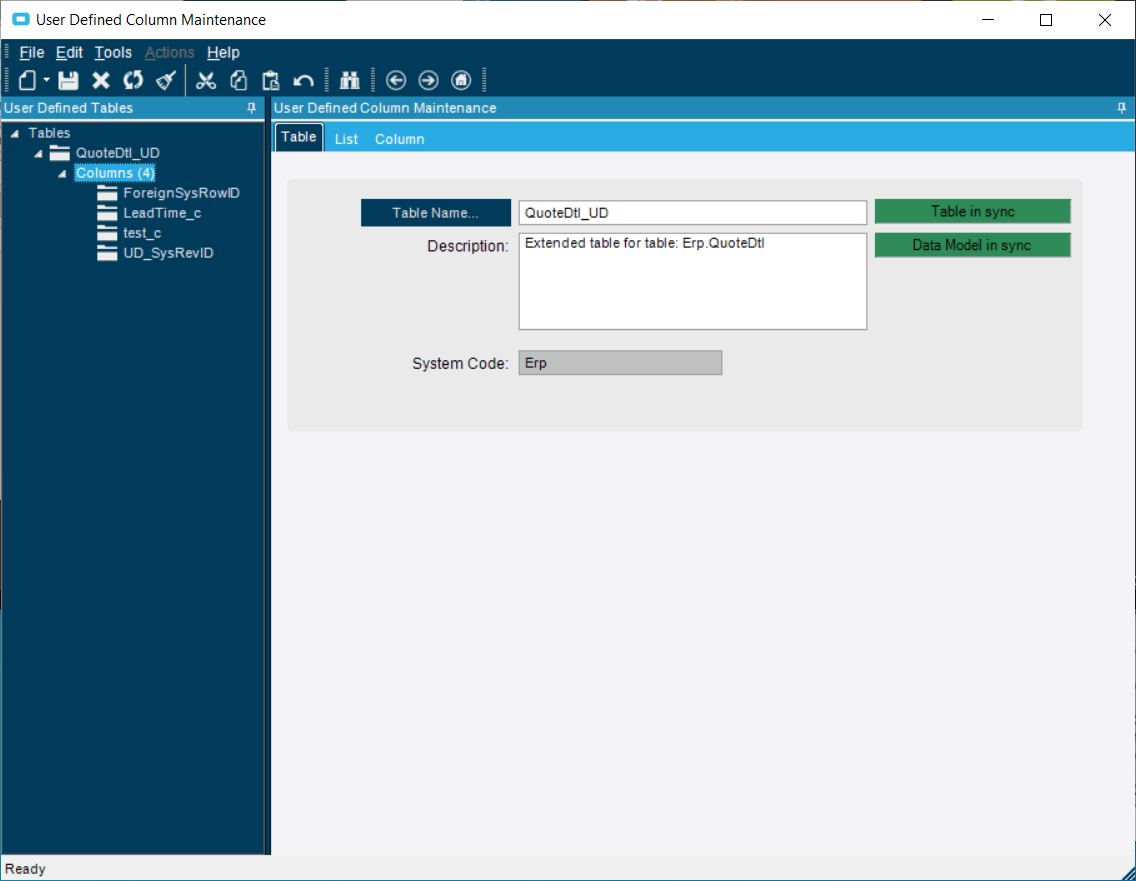

I am testing the 10.1.600 -> 10.2.300 upgrade, and everything seems to be working great, with only 1 exclusion: Reporting
It seems that most of our Custom Reports are failing. For example, when running the QuoteForm, it fails with:
System.Data.SqlClient.SqlException: Invalid column name 'LeadTime_c'.
I have verified that the UD Column Maintenance shows green:
The RDD has the QuoteDtl_UD table, and none of the columns are excluded:
