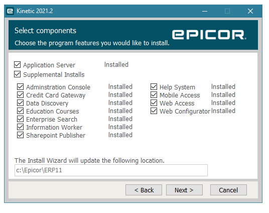

Hi, i am trying to upgrade our on premise Demo Database to Kinetic but during the initial install the application is forcing the install path to C:\Epicor\ERP11 when our 10.2.700 instance is on E:\Epicor\ERP10 and there is no manual way to change this install path. Is there anyone who has managed to get this path to change?

You can’t type into that field from memory, but you can choose another path using the browse button. Browse to drive E:, and then it creates a folder called Epicor, and another inside called ERP11 automatically.

There still doesn’t seem to be a browse button anywhere
The next screen is just confirmation and start the installer.

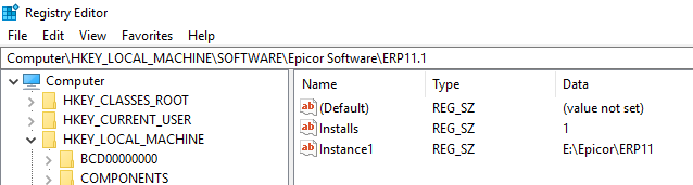

I think it’s doing that because you’ve already gone part way through the installer with the incorrect path. Probably a registry setting somewhere been set.
