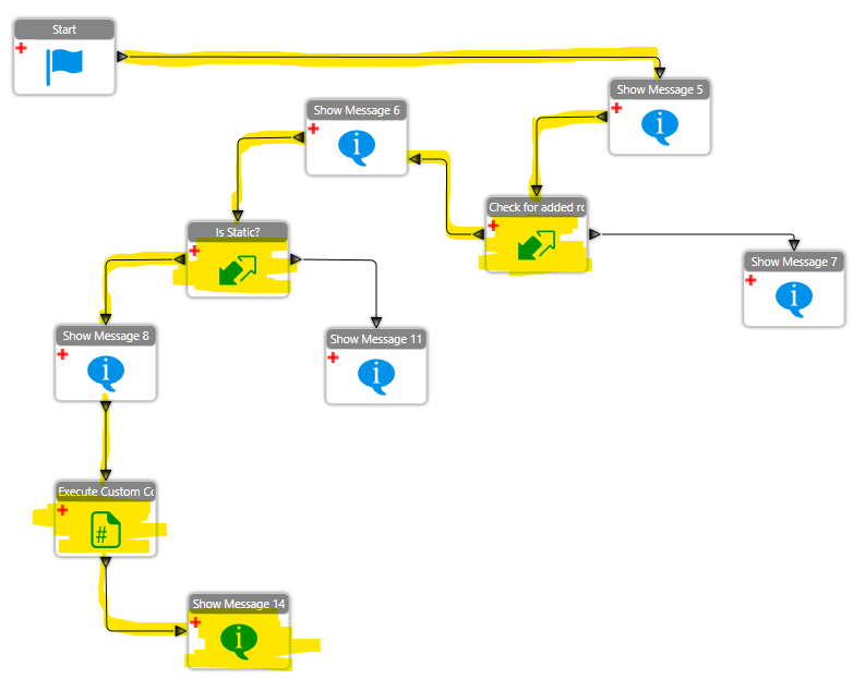

Ok. Happy Friday everyone! I am stumped. I have a BPM that is supposed to copy some information to UD38 table. I have troubleshooted this thing as far as I can. It’s a data directive on the JobProd table. So when a new job is created, I filter to ones that meet one of two conditions. Either it’s a traditional part that is Make Direct on the order, or a configured part. I am passing all my milemarkers. I have messages setup to alert me to which conditions are met. I also have a message box that shows a bunch of variables that I am using in my Execute Custom Code block. Everything appears to be working as it should. But…
If the part is a regular part, it will update the UD38 table as expected. Using the exact same execute custom code block, it will not update a UD38 if it is a configured part. When one condition is met it updates and when it’s the other (in the same conditional logic block) it does not. No errors. I don’t even know what else to say. It “should” be working but it just isn’t. It’s executing the custom code just the same, it just doesn’t update the table at the end. Any ideas?
This is my Execute Custom Code block:

So the the code and diagram above are to execute once when making the new Job, but isn’t firing right when the job is for a configured part?
I think you understood it. I am just all over the place.
