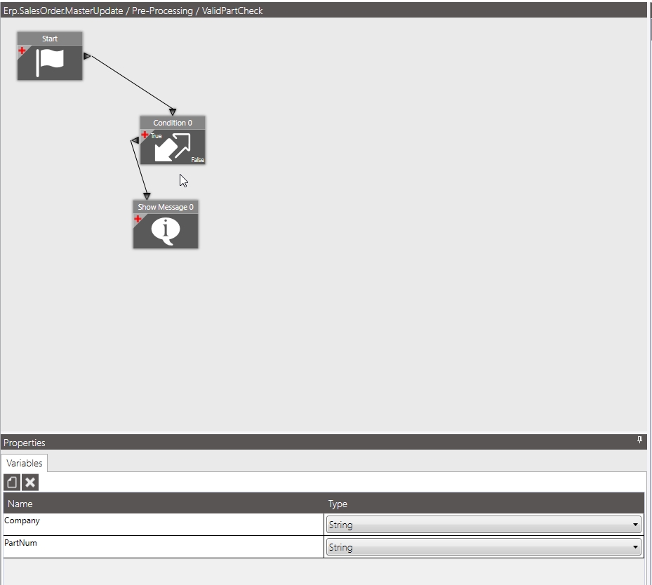

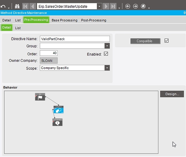

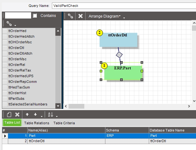

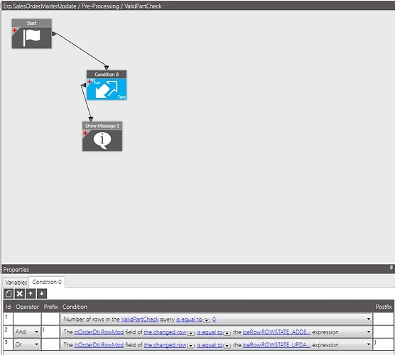

I have a BPM that fires a warning when a user enters a bad part number into a sales order. The problem I’m trying to fix though is when a part number gets changed from a valid part to an invalid part, nothing happens. I was testing this last week and showed my coworkers both examples working. When I went to roll it in to live, the changing part numbers no longer fired a warning. I’m attaching screenshots. I assumed the rowmod updated criteria is what triggered the “changed” part number, but it must not be.
Any help is greatly appreciated

Yeah, RowMod values can be “interesting”…
When I’m not sure if RowMod is being populated/by what
I start with a simple BPM
  • no criteria
  • and a messagebox to display the RowMod and any other related fields.
How do I pass the RowMod value? Through a scalar variable?
Sorry, I’ve only done super simple bpm’s.
I found the value
added = ‘A’ and updated = ‘U’
Do I need to change the icerow.RowState value to ‘A’ and ‘U’ then?
Might you also want to add a BPM on SalesOrder,ChangePartNum (or SalesOrder.ChangePartNumMaster)?
@Ernie is right. Add it on ChangePartNumMaster. Also change the condition OrderDtl.PartNum changed from any to any or Added OrderDtl which covers both new line and modified line.
@Ernie is correct, remember to use your traces and you can see for yourself what methods are called and when. I would actually remove the BPM from update (it’s already slow enough) and move it to the ChangePartNumMaster method only. I believe that fires even if it’s a new row, it’s just an onvalidate method.
