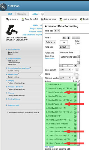

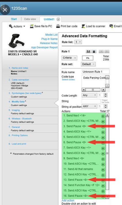

Hello cchang! Do you happen to know the character to PAUSE the Dataworks barcode
We used the 123Scan utility to program the pause code into the scanner with the Advance Data Formatting rules. This utility tool allows you to set the pause after scanning the job number.

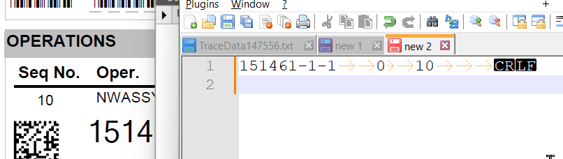

So this is an example barcode that was put onto our Job Traveler’s at the start of every Operation in the Traveler:
To save y’all the hassle of grabbing your barcode scanner to try and scan a blurry barcode, this is the data stored in the Barcode:
$|627460|90|4|04052019|#

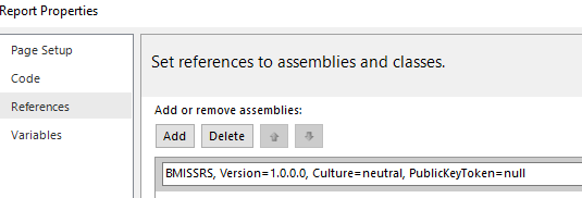

And for any of those interested, here is the code for the DLL that I had loaded into SSRS to generate the PDF417 barcodes on-demand. When the Job Traveler was printed from Epicor, the RDL would load the namespace of the DLL from SSRS which would make the functions from that class available to SSRS.
NOTE: Keep in mind that the Namespaces, class names, method names, etc., have changed as I was developing this, and learning new things as I went. So what is shown here may not always match with other code snippets shown here. However, it should be clear enough what is going on so that anyone wanting to try something similar can use this as a reference, and not treat it as gospel. When/if I ever find the final stuff, I will update these posts accordingly.
Anyways, on with the code…In the report itself, I created an Image field, and added an expression to it, like this:
=SSRS_Barcodes.SSRS_Barcode_Generator.Generate_Barcode("PDF417", "$" + Fields!JobNum.Value + "|" + Fields!OprSeq.Value + "|" + Fields!RunQty.Value + "|" + Fields!JobOper_DueDate.Value + "#")
