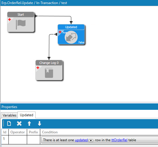

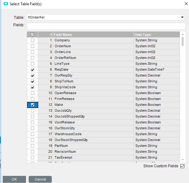

Here is an example of OrderRel: Note how I dont track the SHIPPED qty… this is a system updated field, and there is a history already tracked in the packslip already… no need to have an additional change log for this change.

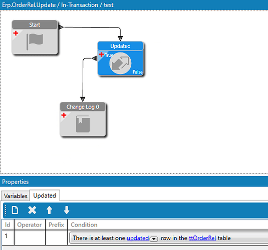

And here, you can see my condition to only look at UPDATED rows: You of course could put additional filters here to only log updated rows IF they also have certain field values set:
You can also add a check to see if MRP is making the change and don’t log if it is - I figure if I’m troubleshooting MRP I’m into MRP logs instead of change logs. We added testing for GetMethod MrpExpCD - if it is Mrp then don’t even run the update.
