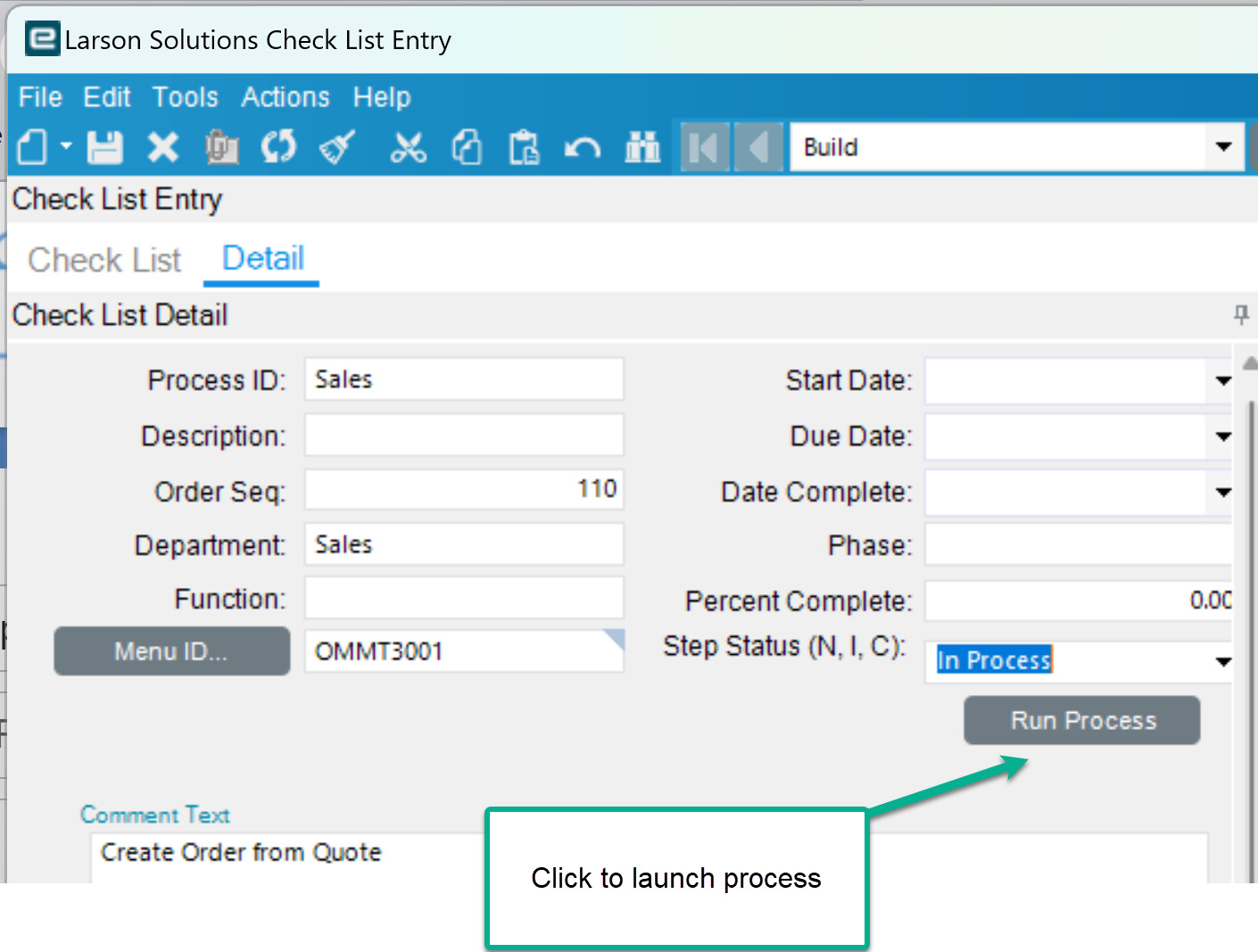

I have been using the implementation check list for 15 years for building companies and testing for upgrades.
It’s a built in process in Epicor that has been there since Vantage 8.03
The use case makes it easy to keep track of the status of your build or testing.

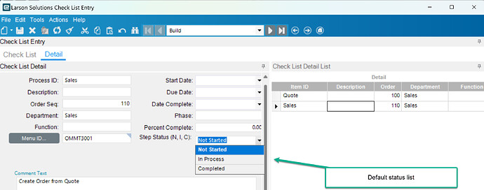

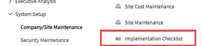

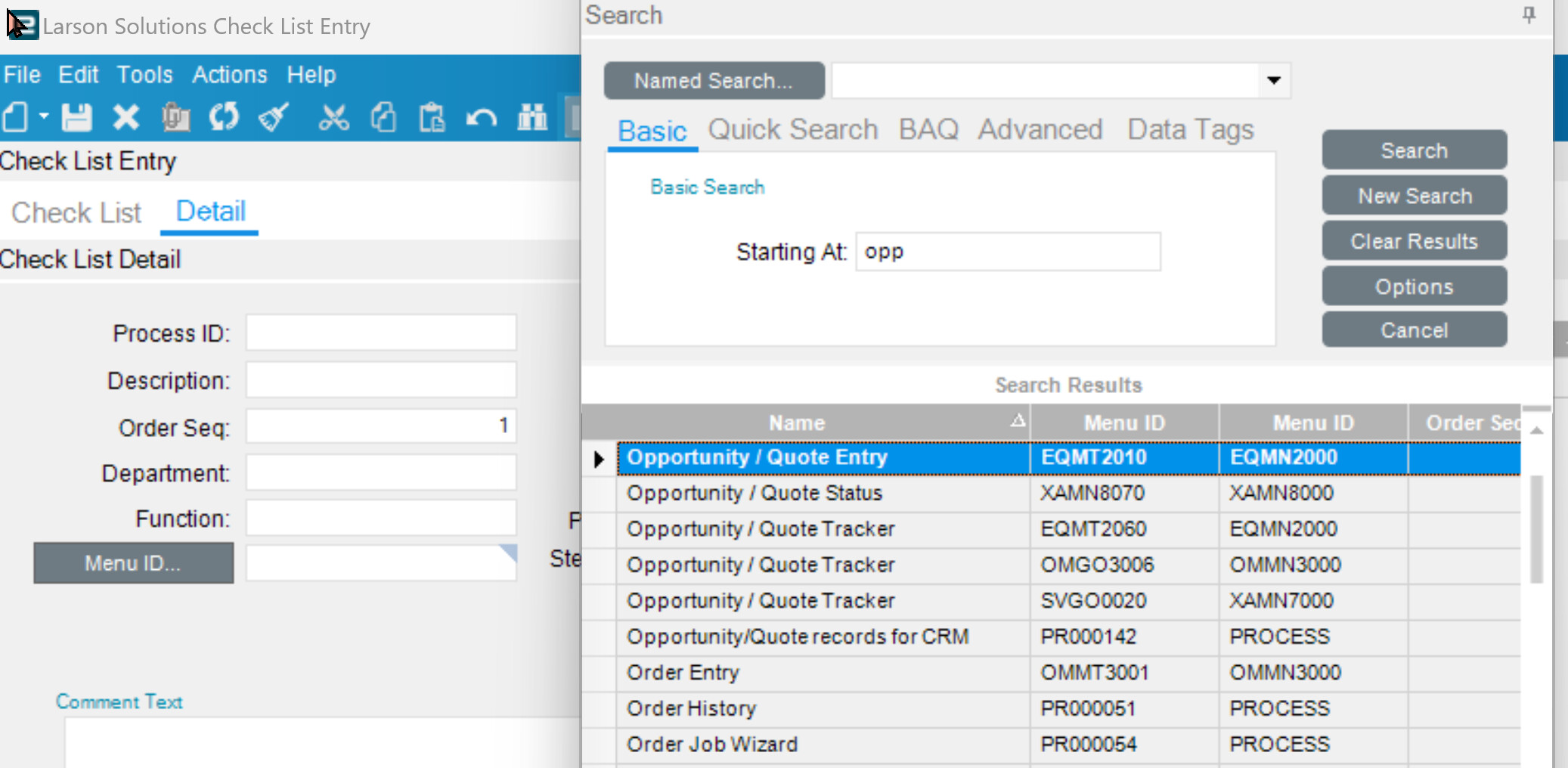

Go to the implementation checklist (may need to move it for other user access)
Create a list name

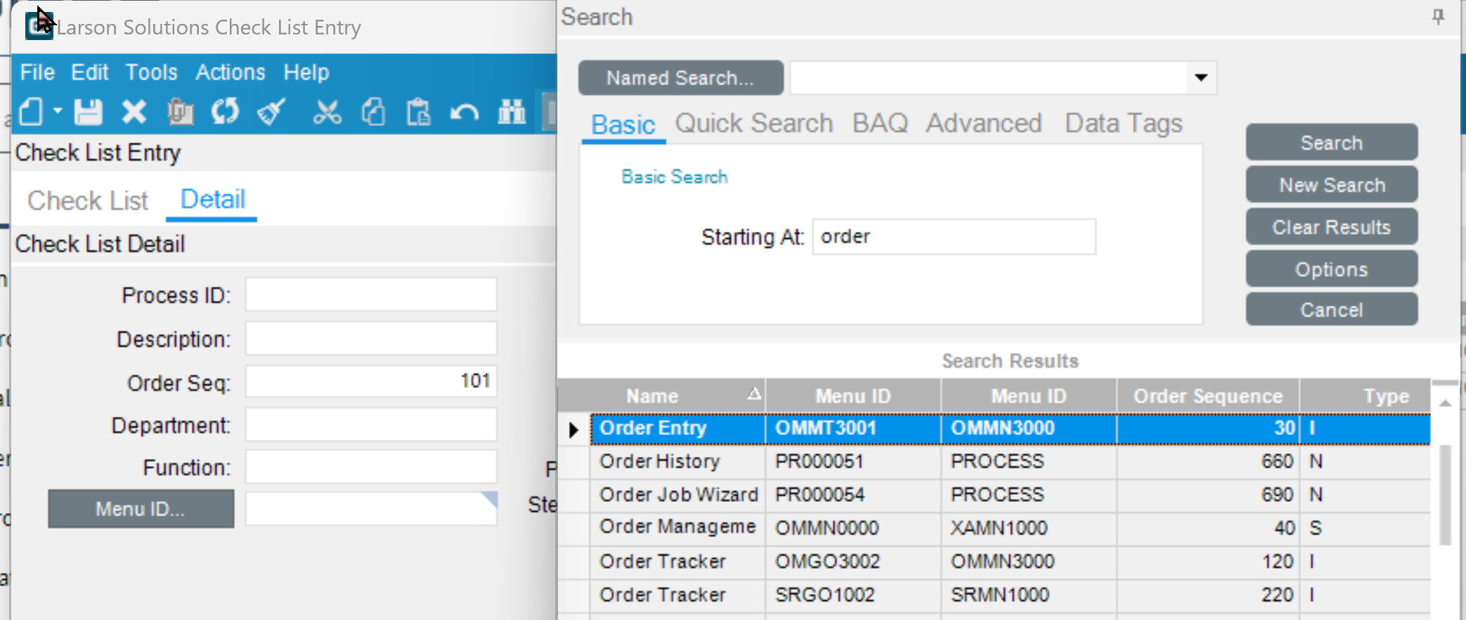

Enter in menu ID’s that you want to run.
Change the status
More details here.
Larson Solutions - Company Build instructions technical notes 20150302.pdf (377.8 KB)

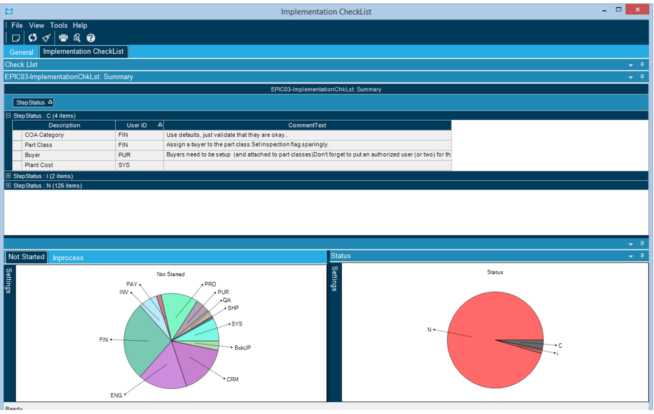

Here’s the status dashboard that I have used for tracking completion.

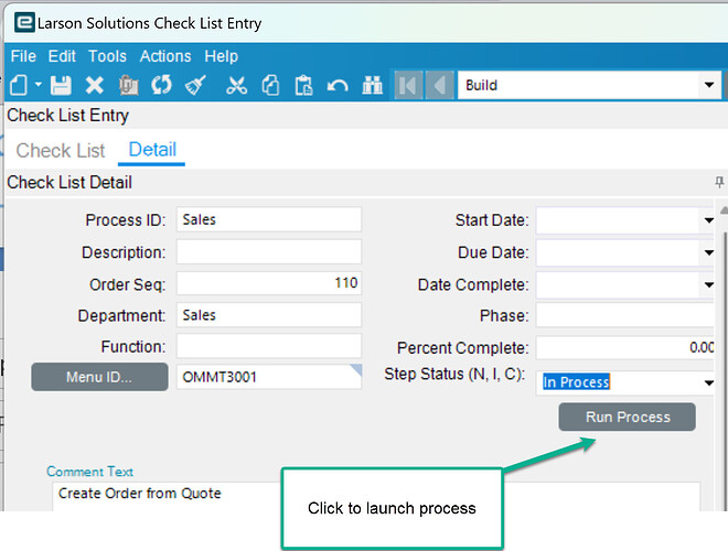

Hi There. I tried to do a test, and then “Run Task” using OMMT3001 as the first menu to test. Immediately ran the Order Entry form to fill out, I did fill and once I clicked on Save it takes several minutes until a timeout error comes up:
What can be the rootcause?
Thank you,
Daniel.
Did you save the task before you ran it?
Typically I will load my test list in before doing any transactions
I have found that some of the process IDs have changed since Vantage 8.03 also
