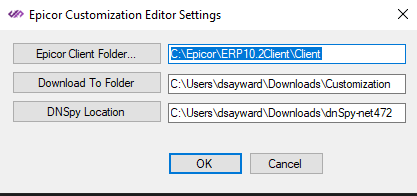

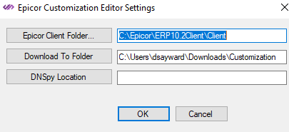

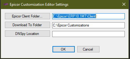

What are your settings? What is your Download Path and Epicor Client Path?
Can you remove the space from the Epicor Customizations download path and try again? (shouldn’t matter but just curious)
Also send paste or PM your JSON file (that gets downloaded to the Customization) wondering if there’s something funny there.
Removing the space didn’t help. I’m gonna try a different customization now…
Tried a different customization, same crash.

There’s a Log File (Created in the Epicor Client Folder) can you send that?
Also what do your settings look like/

Here are my settings now…
