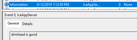

On BPMs I use VS to code and the app server event viewer to get error messages or progress of the BPM.
The event viewer will give you the routine and sometimes the line number of the error.
If you don’t get line numbers add log entries to follow the process like below.
Ice.Diagnostics.Log.WriteEntry(" email from is good" + EMAIL_From);
DMRHead = Db.DMRHead.Where(DMRHead_Row => DMRHead_Row.Company == ttDMRActnRow.Company && DMRHead_Row.DMRNum == ttDMRActnRow.DMRNum).FirstOrDefault();
Ice.Diagnostics.Log.WriteEntry(" dmrhead is good");
When you do get a line number it is referencing the whole routine and not just your BPM, so you need to load the source file from the app server to find the number and it is not always the exact number. could be a line before or after. The number at the end is a directory that is generated with each BPM save. \c-e10app1\d$\Epicor\inetpub\wwwroot\Pilot\Server\BPM

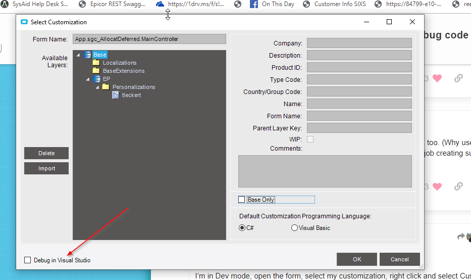

I’m in Dev mode, open the form, select my customization, right click and select Customization, now where do I find the debug checkbox?
When you run a customization in developer mode, there is a Debug In Visual Studio checkbox on the bottom left of the selection screen
However the visual studio plugin above allows you to write the entire customization in visual studio too.

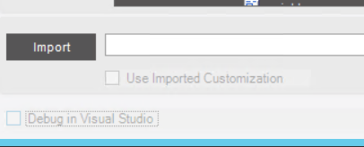

Unfortunately, mine is greyed out.

If your Debug In Visual Studio is grayed out is because you do not have Visual Studio installed.

I just signed into VS, thought maybe that was the issue but still greyed out Debug checkbox. User maintenance checkbox maybe?

After attempting many combinations, here’s what I can say.
VS 2019 or 2017 Community does not integrate with 10.2.
I had thought I was missing a component, extension, or library… but
VS 2015 works with 10.1.600 right away, just install and it immediate shows the Debug in an accessible way.
