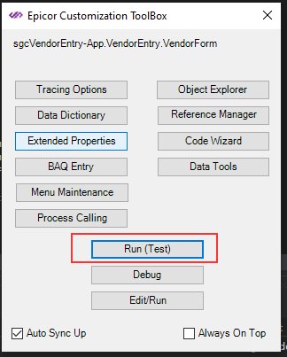

Just published a new version of the helper library with an enhancement that the talented @gingerhelp (Adam) cam up with.
This allows you tun Run/Test a customization without necessarily committing those changes to your current (deployed) version.
This button in the toolbox will Run your latest changes wihtout over-writing your actual current code. Very handy when you aren’t sure if something will work.
You can download the helper libraries from the Visual Studio Market Place.

Just added support for 10.2.500.X to the Library, the Helper can be downloaded from the extension page at Visual Studio Extensions Site.

This hooks up directly to Epicor and downloads the customization code for you, creates a project lets you edit it and test (from visual studio) without having to import paste the stuff back in etc.
Watch the demo video (up top)
