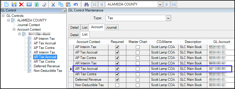

@E102016 You highlighted AR in the screenshot, but it’s AP, right, since @Evan_Purdy is asking about a PO…
Correct. All taxes assigned to that tax type would go to the AR Tax Accrual GL. That would probably be the way forward. It looks like you can have multiple GL controls assigned to a Tax type but not sure how that would work as we have always used in a one to one environment.
You are correct. Read the body of the question as Sales Tax and assumed AR.
