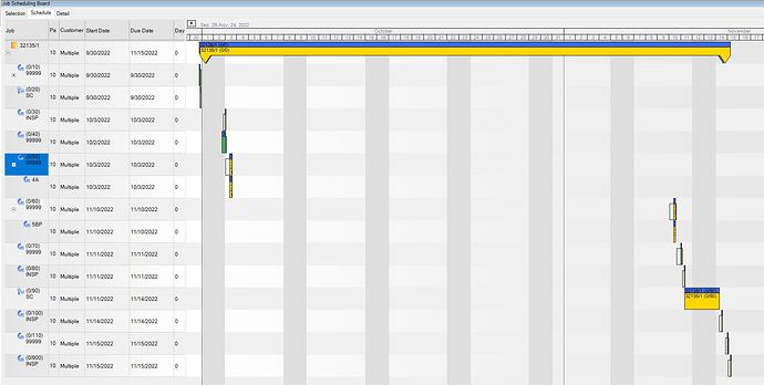

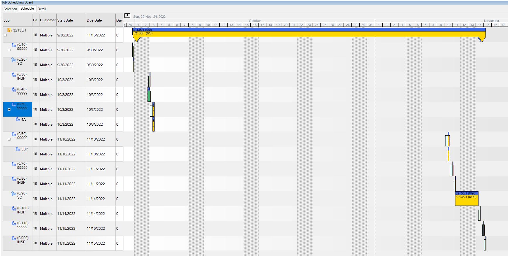

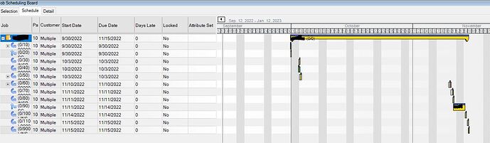

Why is there a gap in my jobs operations?
I am looking at the Job Scheduling Board. I can see a large gap of over a month between two operations. Op 50 is a finite resource op, but op 60 is an infinite resource op. Op 50 uses ID 25, and Op 60 uses ID 5BP00062.
Can you tell what is going on from my images?
How can I figure out what is causing this gap in my operations?

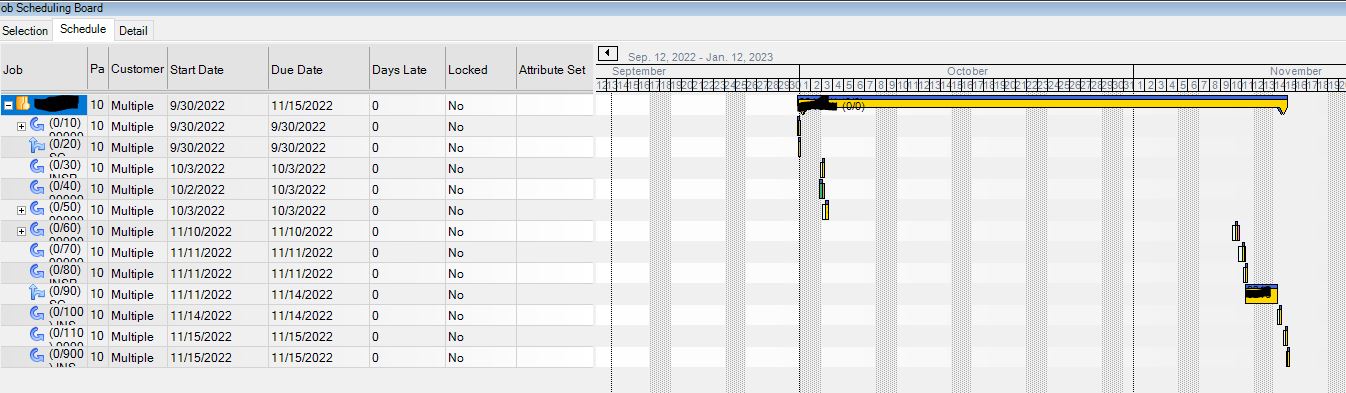

Can you expand this line into as many levels and post a new image:

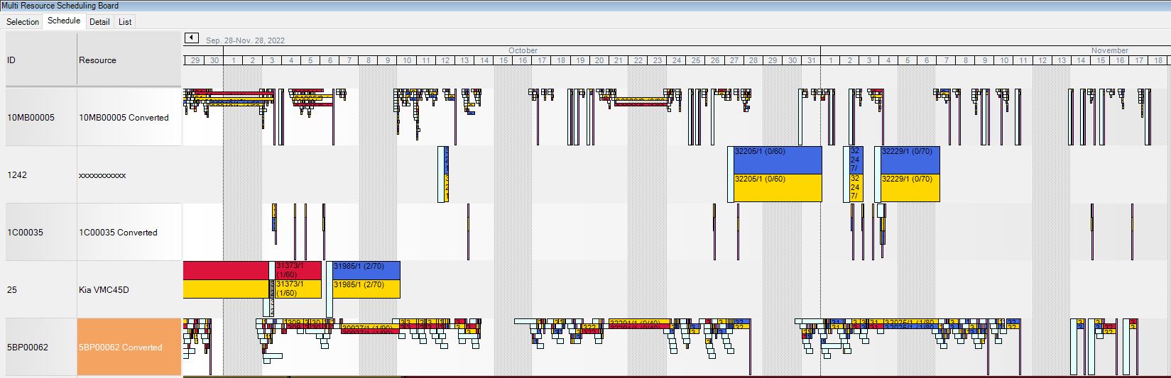

How about a picture of the resource scheduling board for op 50 resource? Could that resource not have another window to schedule on closer to op 60?

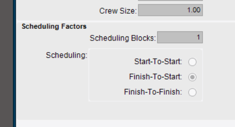

What’s your scheduling set for the operations. Those on the left compared to those on the right:
All of our ops are set to Finish-To-Start.
Do you have these set:

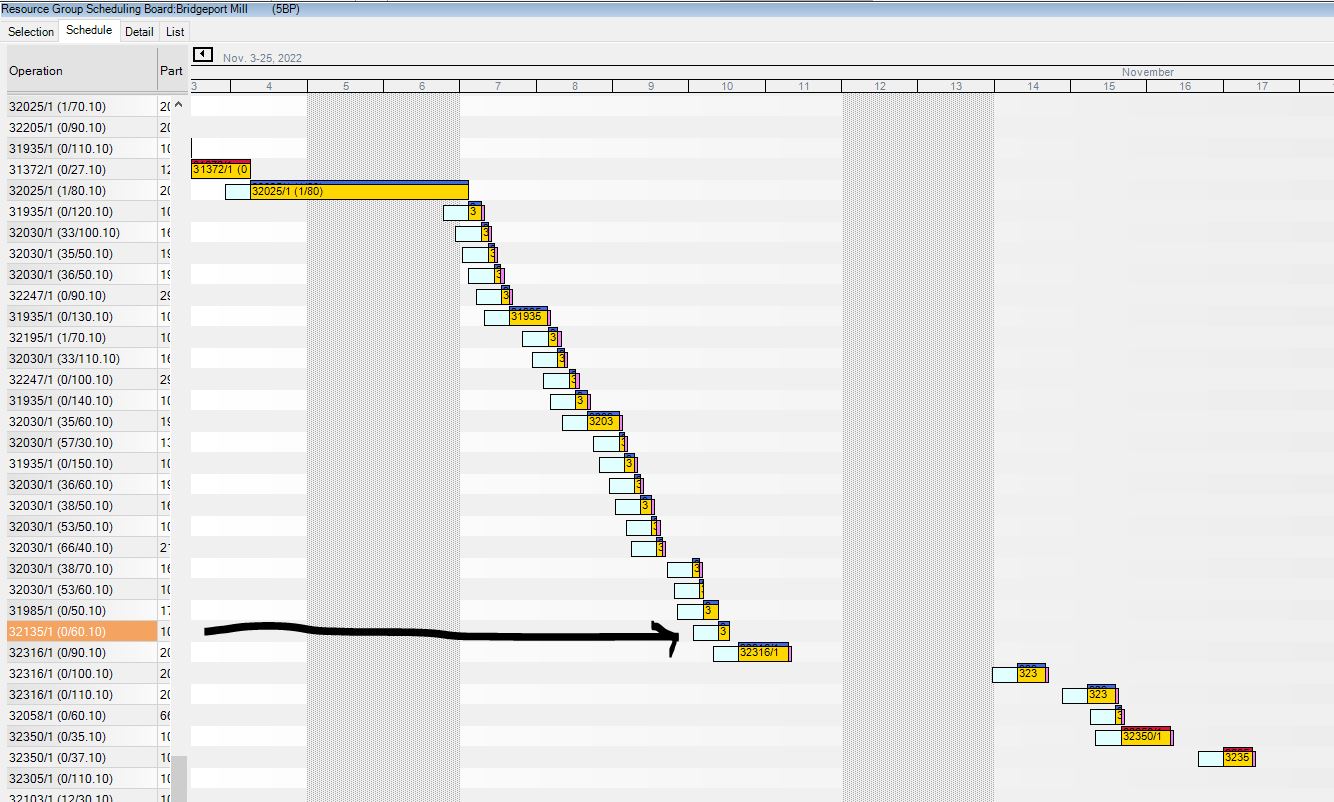

It looks like the jobs are not being scheduled infinitely to this resource. That was it! Someone set this resource to finite! Dang someone!
I think the best took for finding this was the resource scheduling board. But I had to use the multi resource and job scheduling boards to track it down.

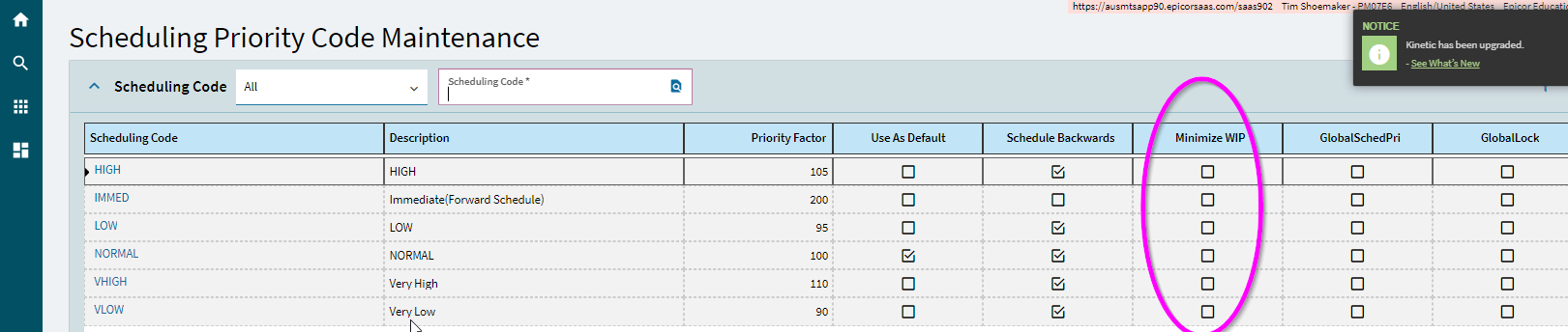

BUT if you choose a Scheduing Priority Code that has the “Minimize WIP” flag set, then the system will do one additional reschedule after the completion date is done… in other words, it:
  1. backward schedules
  2. Forward schedules, setting the completion date
  3. Backward schedules using the Completion date as the target. This will compress the schedule.

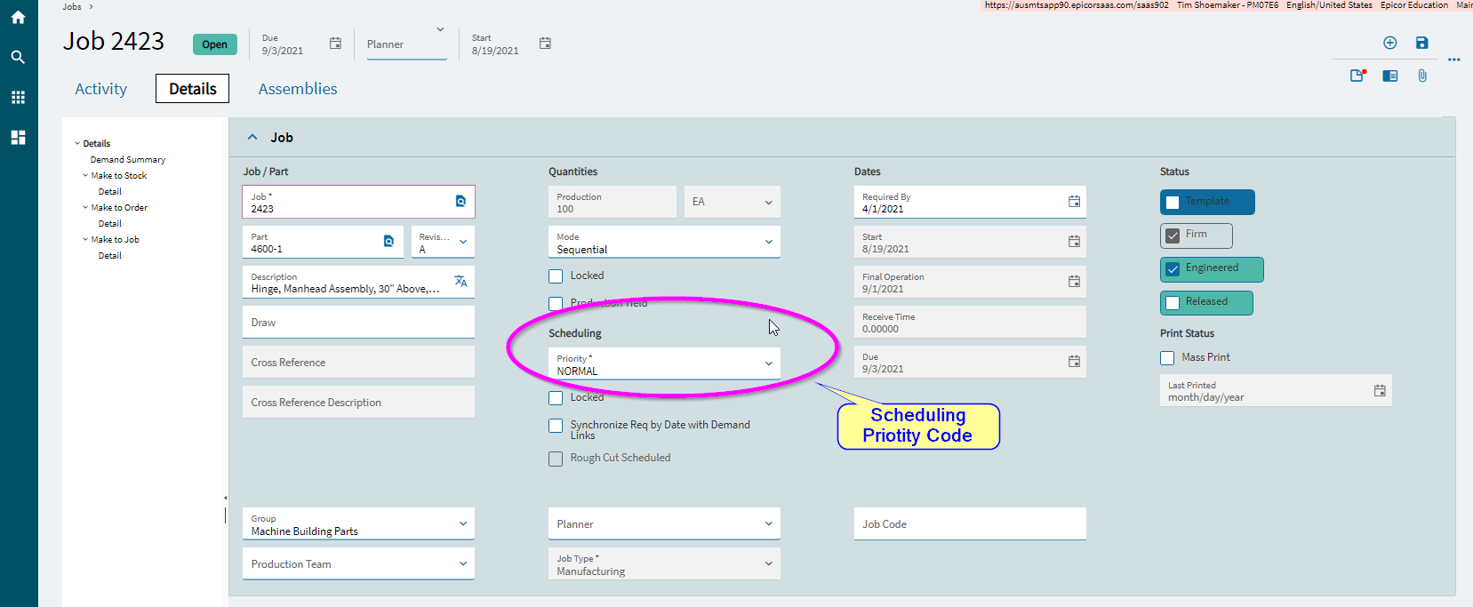

Create or change one of your current Priority Codes to have the Minimize WIP flag set to true. If you set this on for the DEFAULT scheduling code, then it would be used by all new MRP jobs:
Here is where the scheduling priority code is used in the JOB.
