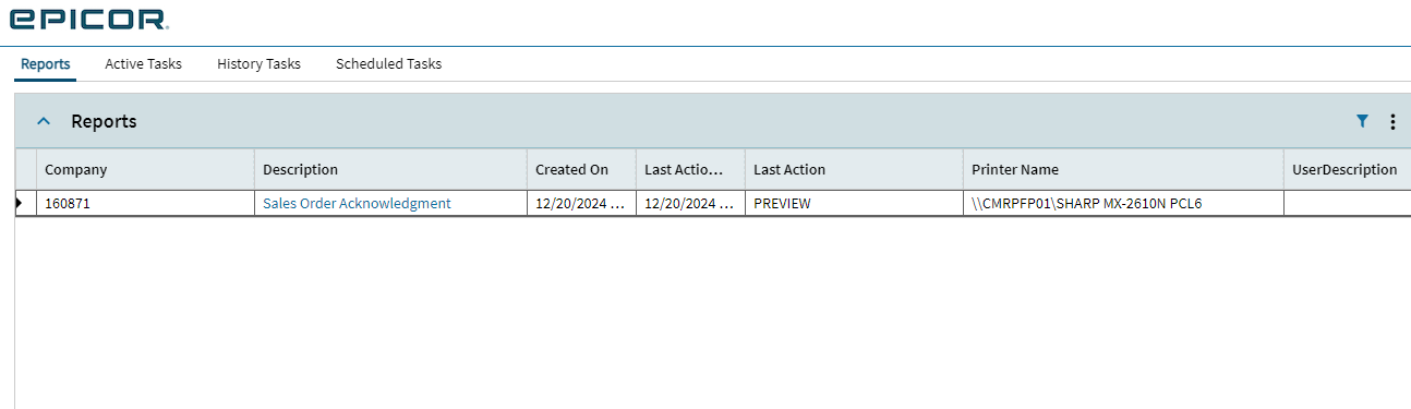

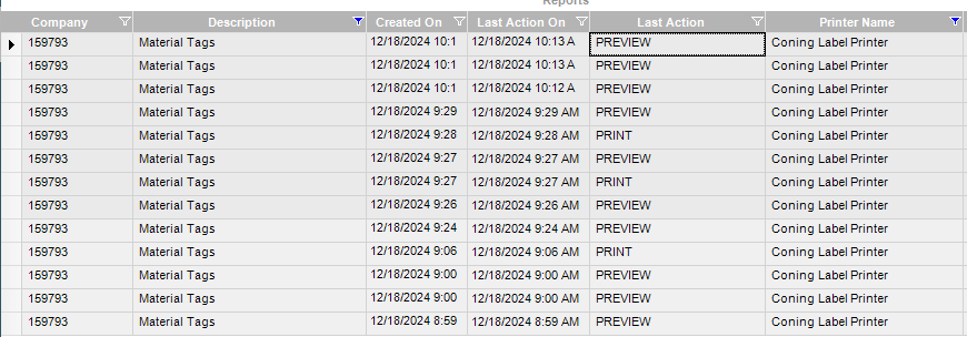

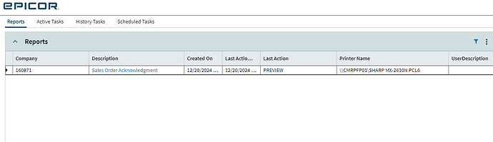

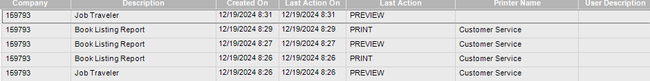

The main difference is that printing will send the printer name regardless where it fails to actually print and sends a preview instead.
The top line is the actual print preview.

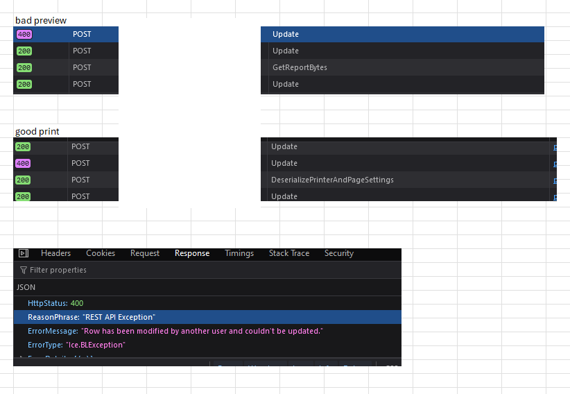

I went back and looked at the calls happening. I’m seeing a consistent pattern after its submitted to edge agent:
a preview will result when the first update fails and the deserialize printer and page settings doesn’t get called.
It looks like 2 updates get sent every time a report is submitted and one gets locked out by the other. I’m adding this to my ticket and maybe that will get some traction.
