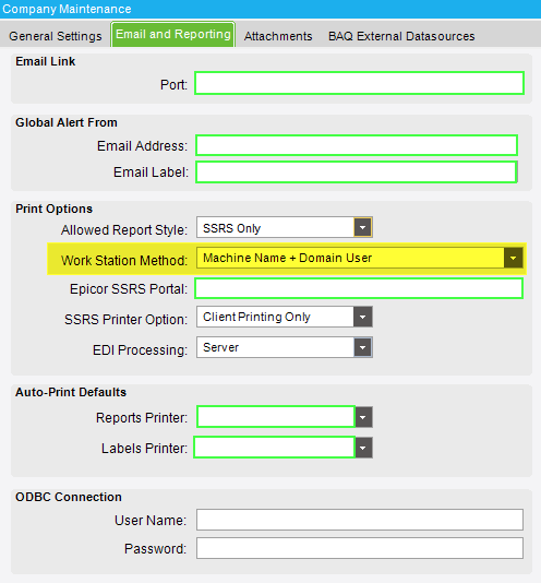

A long time ago, in a galaxy far, far away, we were having some issues with an Epicor report that UserA would run popping up on UserB’s computer (if they were logged into Epicor). I learned that it was best to set the Company Maintenance - Print Options - Work Station Method to “Machine Name + Domain User”. This kept the reports that UserA would run from popping up on another user’s Epicor session. It’s been so long ago I don’t remember if the report would show up twice in the System Monitor or under UserB’s System monitor list?
But I wonder if it’s possible that something similar is happening for you? Except the report is being sent to the printer instead of to the monitor. I don’t think the reports would pop up right away either…sometimes it would happen right after a user would log into Epicor.

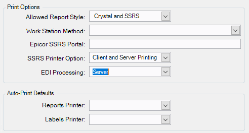

I absolutely LOVED seeing this! Thank you for the laugh on a Friday. I have attached a screen shot of what I have just to see if I need to change anything.

I wouldn’t think you would want Work Station Method blank… I wonder if you set it to the appropriate setting (for us it is Machine Name + Domain User) if that might make all your problems DIssssaaaaapppppeeeeaaaaarrrr… :rainbow: :butterfly:
LOL Just kidding…it’s probably something else but that might help… :person_shrugging:
I was definitely laughing at the Star Wars intro. Really made me chuckle here! :rofl: It is hard to tell what the “appropriate” setting would be for Work Station Method. I can try different settings just to see what happens. I will keep you updated! Thank you for all your help so far.

HAHA! Thank you for the movie references today. Quick question though, what is the difference between Client Printing Only, and Client and Server Printing?
This post might be good to read to best answer that question. I wonder too if that setting might be a problem depending on how you have other items, mentioned in the article below (like Printer Maintenance), setup…
