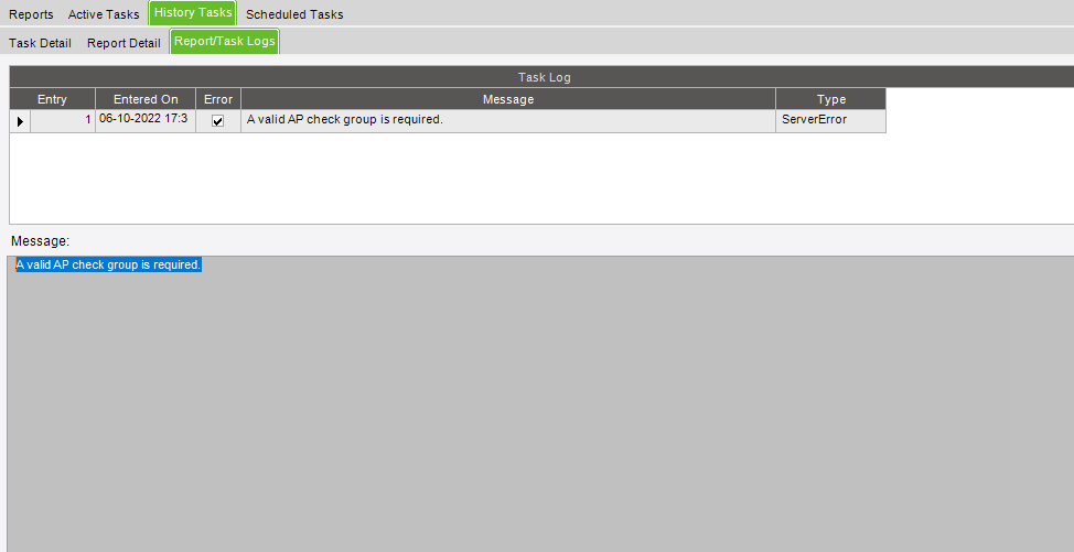

I am trying to Autoprint from Payment Entry Screen.

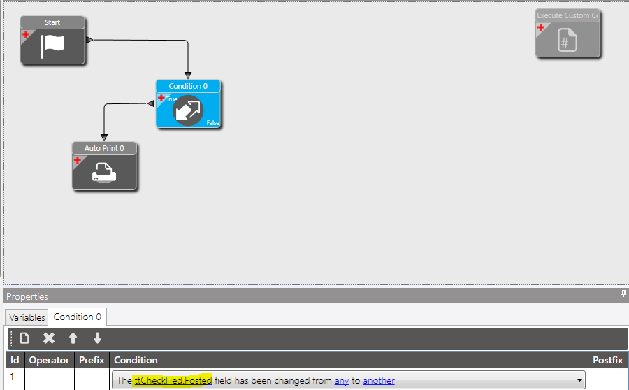

I have created a datadirective on Checkhed
The condition is as soon as the payment is posted it should autoprint.

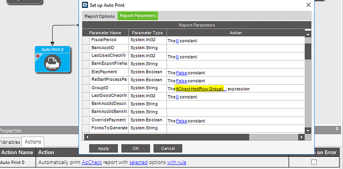

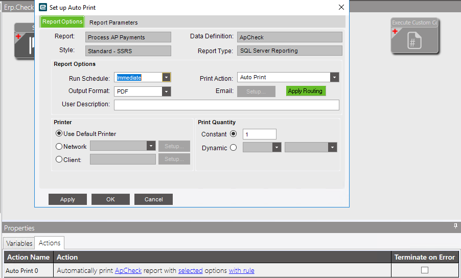

I have setup the parameters for standard report style
I am passing Group ID as below
But on the system the group is posted successully but Unable to print the Report and below is the error
Am I missing something which is important an.
Thank you.
At first glance, it seems that the ttCheckHedRow table no longer contains the GroupID value - and that would tell me that you are triggering at the wrong time in the process.

If you are trying to do it after Posting, then the tables are empty as all of the data has been moved to the APTran tables.
This may be your issue.

The issue is that Epicor looks at the table Erp.APChkGrp to validate that your Group is valid, once you post the Payment (Group) Epicor deletes your rows from Erp.APChkGrp and hence it is no longer found.
Once your AutoPrint runs in the Standard Directive, it is too late.
Your best option is to recreate the APCheck as a BAQ Report and invoke that instead.

Odd part is that Epicor is trying to regenerate or generate the Checks again. Which is a bit odd because I dont think you can post without ever already generating checks and your ReStartProcessPayments is False. Are you guys invoking the Posting from API instead of UI (hence the ability of circumvention)?
The error you receive is coming from the Internal Process of ProcessPayment when it tries to decide if it should generate numbers.
If you are invoking the posting from an API then simply Run the Report there and then post.

Thanks @hkeric.wci Finally I had to do the BAQ Report solution and that works perfectly well
