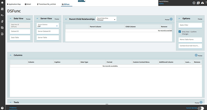

I created the function, and setup the button and file picker. However, I can’t seem to figure out how to get the data from the function into the comments field. I did setup the dataview as Hannah said at the beginning of that post. Since I am not creating a grid, I don’t have anything to link the dataview to. I think I have to change the dataview for the Line comments field, and then somehow keep the original data from it, and append the data from the function, then save the field.
I imagine that I could easily change the data EpBinding for the line comments text box to point to my new dataview. But I don’t know how to merge the values together.
Do I need to setup my dataview to have a parent child relationship?

Here is the setup I have so far. Without getting into my function. I am not sure where to look next. I think I need to get my dataview working properly.

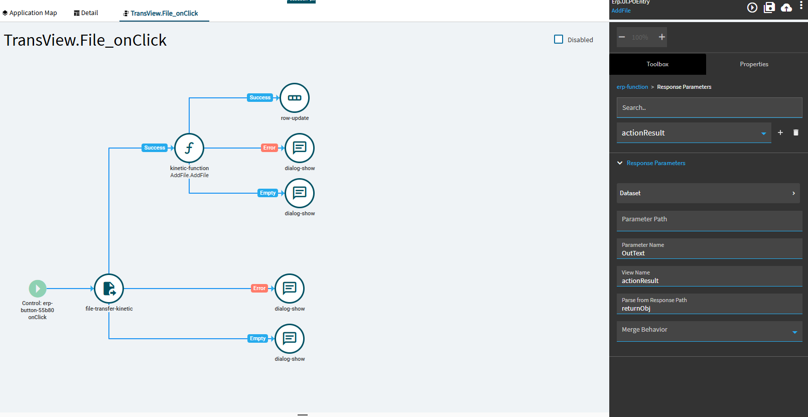

I appreciate you working through this with me. I think we are close to a solution. Here is my event. I added on error and on empty dialog boxes to each. When I run it now, I get a function Error from this event path. It doesn’t matter if I choose a file beforehand or not. it always shows my function error dialog box.
I simplified my function so it doesn’t execute any custom code. it only has a single dialog box attached (Show Message widget). I never get that show message widget. I only get the error on the function from the event above.

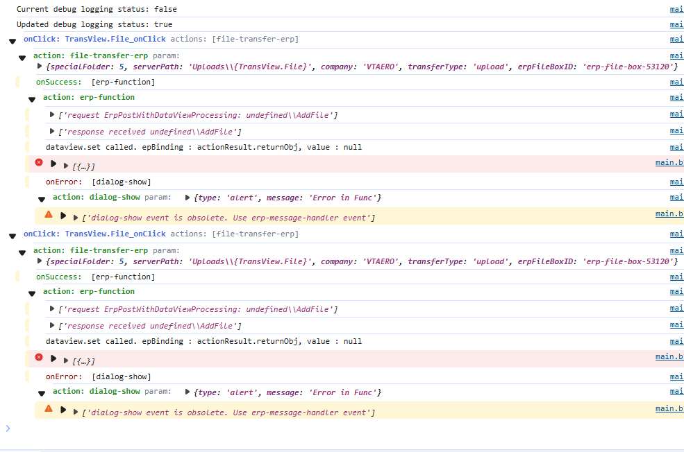

Here is the console output. Once without choosing a file, and once with choosing a file.

What I noticed in your earlier post was actionResult.returnObj, value:null even tho I saw no evidence you were specifying returnObj in the response params. Guessing that means studio assumes it. My understanding is that putting that in ‘parse from’ makes it parse the result from that point in the response json making returnObj go away. There’s no change on that so let’s put that aside for now as there’s an error earlier in the stack…
erp-function request says undefined\AddFile. this means your request params are wrong. It’s prolly supposed to be librayName\functionName so maybe AddFile\AddFile (?) but again I’m guessing.
I only get a drop down to choose the library and function. I am not sure where that undefined.AddFile comes from.
I tested my function in REST API Helper and It returns Hello World as part of the debugging. :thinking:
Okay so its coming back to me slowly :wink:

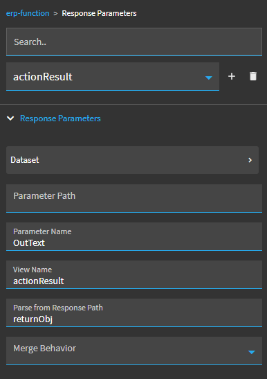

The actionResult.returnObj, value:null is normal. Happens on all function calls for whatever reason. and the undefined\AddFile is normal too. The fact that no other info returns is the problem. I think youneed to recreate your kinetic-function widget. I believe, if at anytime you clicked Dataset btn on response page, it breaks.
Before dataset btn:
After dataset btn:
studios strikes again! sorry.
dropping off for a while. best of luck. FWIW, my response props above work fine for a simple text function returns a var called ‘code’.
Check your AddFile response in network tab and if similar to mine:
Try just OutText in Parameter Path of response props.

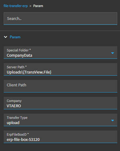

Here is how I setup the onclick button event:
