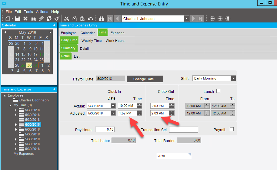

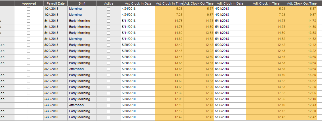

I’m working in an updatable dashboard that displays information from Time and Expense entry screen LaborHed table (we are only changing existing record), some of the updatable fields are the Act Clock In Time, Act. Clock Out Time etc. which are displayed in hours.minutes for example 11.50 is equals to 11:30 AM and 23.50 to 11:30 PM, of the requirements is to display the time in hh.mm.xm format (image 2).
I was thinking in adding a time editor to the dashboard in order to display the required format so I created a customization based on my dashboard assembly added the time editor and tried to link it to the time column of the grid but I got the following error which is related to the data of the column (I believe in the source code time is converted to decimal in order to store it in the DB).

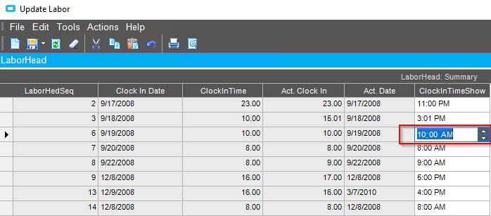

You can do this but the BAQ does not support making this behave like a TimeEditor field. Below is the end result of how it would look in an updatable dashboard and below that are instructions for doing this.
1 - Create a calculated column in your BAQ. This will convert the decimal value to a datetime (time format) value
2 - In the General Properties for the Update make the calculated column and column you want to update as updatable. Set the Format of the calculated column to {time} using the advanced column editor
2.5 - Now you will need to add some code for going from datetime back to decimal when updating the proper column
3 - Assuming you have made a dashboard from this Baq make it an assembly and tie to a menu item so you can apply a customization.
4 - In the customization code you will need to add some custom code. I assume you know where to put these statements and if that is incorrect let me know and I can add the full code.

This is the image 2
And error
If you follow what I posted there should be no problems like this anymore.

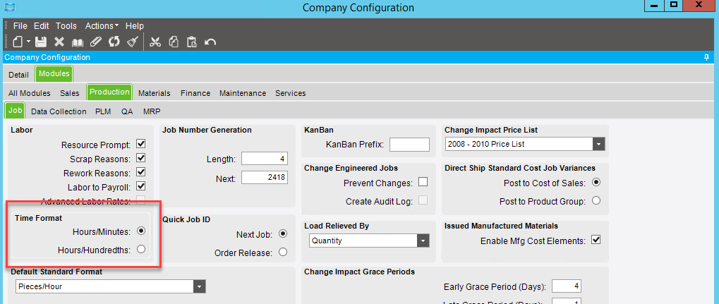

Thank you @danbedwards you’re the man! It worked like a charm. I just did a small change when converting from datetime to decimal, we need to check the Time Format from Company Configuration to know if we are going to divide either by hundredths (100) or minutes (60).

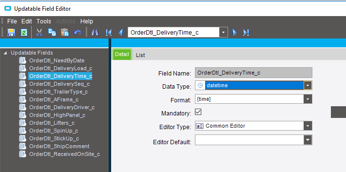

I am doing a similar thing here, however I am using a UDF for the delivery time.
On the Updatable BAQ, I have set the Format to {time} and the Editor Type: Common Editor
However, on the dashboard, the control shows a calendar. But when you type, only the time can be typed in.
Do I have to create a calculated field or is there a quick way of making the control to be a Time editor?
@TobyLai you need to create a customization for you dashboard like step 3 and 4 posted by Dan.
